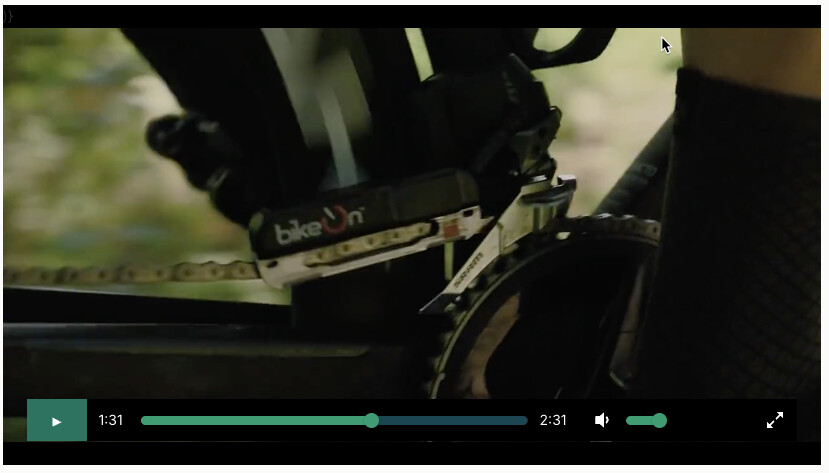

It’s real as in that it exists. As for accuracy? I have my doubts.
Considering they can’t put a chain on the correct way I fail to see how they can measure anything from it correctly.
To be fair they do say that it isn’t compatible with srams flat top chain…
Didn’t know sram did a flat bottom chain though :joy:
Flat bottom chains are a new development. It’s also apparently not compatible with sram flat top chains so not sure why they decided to demo it using that system. Nothing they have showed so far makes me have any confidence in the product.
Flat bottomed chains, they make the rockin’ wheels go round!

Hi, I am the engineer behind this product.
Thanks for your comments and interest in our product.
We are a small team of three and hired a production company to make this video. We did not install the chain, nor did we have any control over that process. This was a last-minute video due to various circumstances.
Our choice was either to scrap the entire project because of this mistake or hope for understanding - after all, we do not market the chain, the bicycle, or the actor featured in the video. None of that is what we are promoting.
I am happy to explain any details of how our power meter works, and I am glad to answer any other questions or concerns aside from the chain issue.
