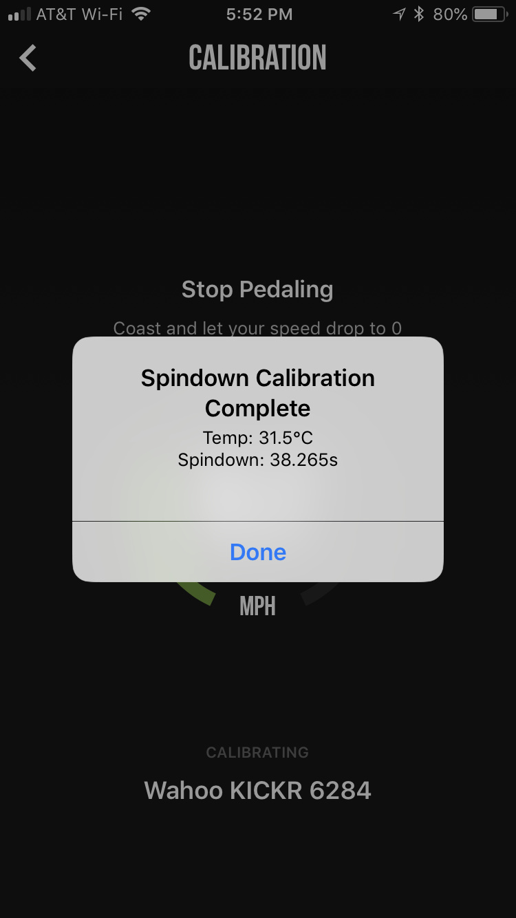

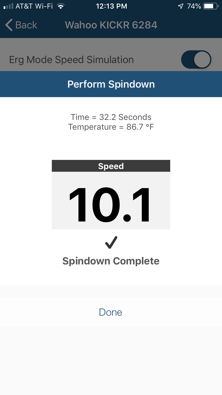

I take screenshots of my phone, but the Kickr uses an optical sensor for estimating power and it doesn’t seem like there is anything to track… Wahoo app:

Wahoo recommends using Wahoo app for spindown, and that app doesn’t provide an offset. Without contacting Wahoo support, I’m unclear if the offset means anything. And then there is the whole optical sensor thing. Wahoo power estimation via optical sensor depends on no interference from dust or sunlight. Wahoo is not using a strain gauge where calibration numbers mean something. A call to Wahoo would help clarify things…
Right that’s what I saw last night…temp is the other number.
