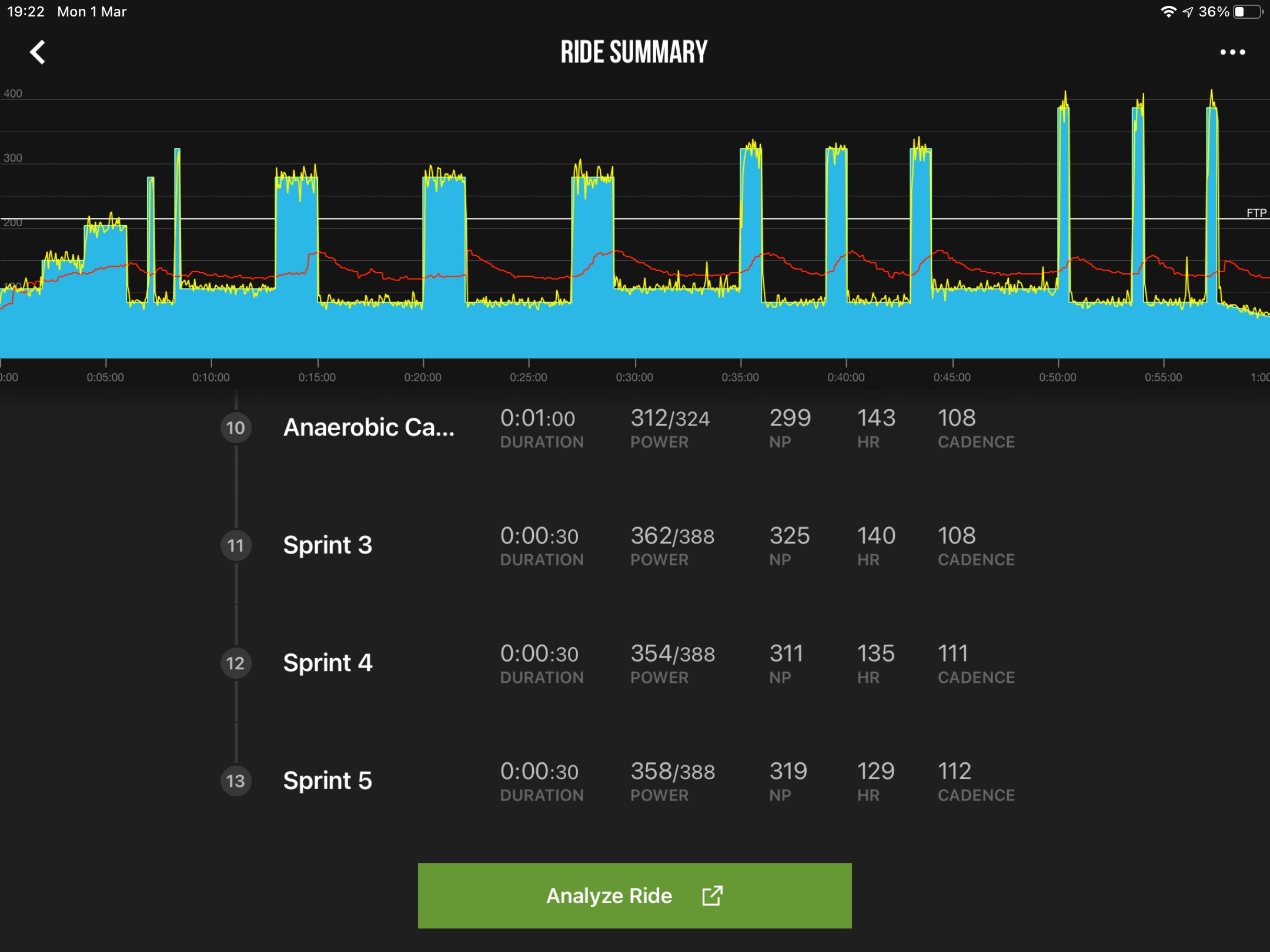

This would be a pass. If you stopped in the middle of the set for an extended duration it would be a struggle or fail.
