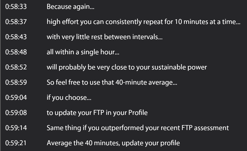

The workout text is that the average can be used iirc (last time I was distracted by zwift!)
If I get a chance, I will check the workout text. The main workout info is lacking that statement.
I don’t necessarily just use that workout, kinda know how sweet spot should feel at this stage - Carson is my go to if I’m still not sure. Anyway, still very much n=1, and very much a personal mental issue with the ramp test!
Yes. Here is the relevant workout text:
and
