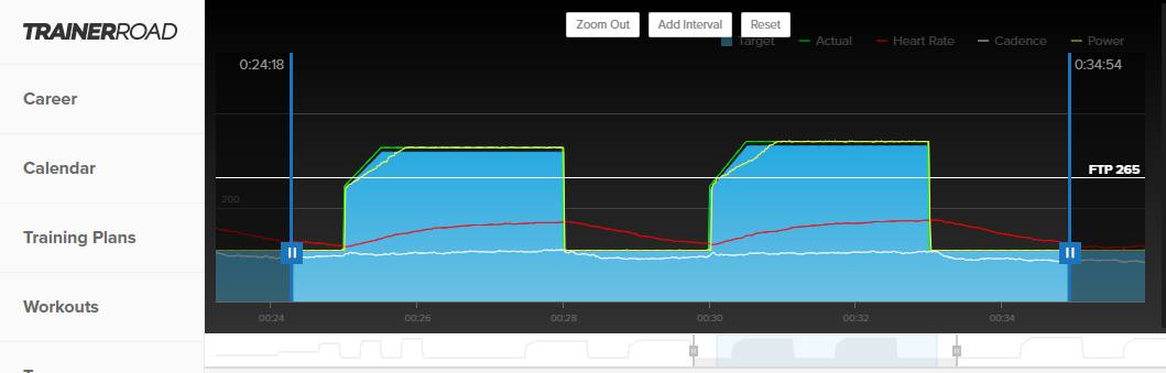

Here’s an example. You see, I raised the intensity during the cooldown and while riding the blue showed 200% across all of those intervals, but when the image was created it looked like this.
I found the same this weekend (I’ve not added on much extra before). Trouble with changing intensity in the cool down is that if you want to sit mid-Z2 straight after the intervals, you’re constantly fighting against the decreasing intensity of the cool down. Next time I’ll change to resistance mode - it’s just annoying you have to navigate away from the workout on mobile to switch it on.
Here is an example of Taylor -2 where the rider increased intensity during the 2nd set of intervals. Increased intensity again during the 3rd set of intervals, then set intensity back to 100% for an extended cool down period.
You can see that the solid blue graph of the original workout remains true to the original prescribed workout after the data syncs to the rider’s TR career.

I indeed tried to modify the intensity today again, and not change it as suggested. I think there is some lack of knowledge on my part in the actual, power and target elements on the graph.
Maybe, the Yellow Power line is the user power output, the green actual power is actual target, and the blue graph is the original target?
In the middle and at the end of the ride I increased the intensity by a few % points and I would imagine the blue bars to also increase.
This is correct:
Yellow= Power reading from power meter
Green= Target Power with intensity adjustment
Bliue= Original Target Power
