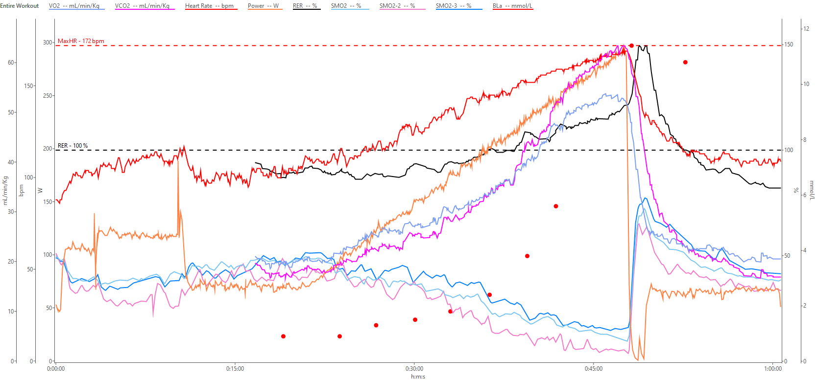

Moxy seems to be gaining some traction finally. Andri Feldmann is doing a ton of research with the device, too.
I was eyeballing the device for a few years before I bought a 3-pack. They’re fun to play with and pretty easy to use. It’s a shame there aren’t more places you can rent one. I’ve considered renting mine out since I know I would have liked to “try before I buy” when I was researching them.
Here’s an example chart from a ramp I did in February. It’s pretty busy, but gives you an idea of what you get. I was lazy and put the Moxy’s all on working muscles. It’s better in my opinion if you put one or more Moxy’s on non-working muscles so you can see oxygen desaturation from you body farther away from the working muscles.
