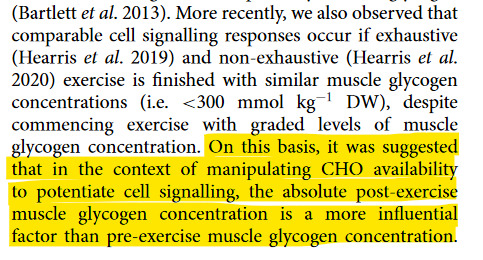

  • studies suggested that training low augments endurance adapation to a higher degree than exercising “fully loaded”
  • the most recent studies suggest (including this) that it is not necessary to train with low glycogen. Elevated signals for endurance adaptions seem to be the result of how low you end a session, not how low you are during the session
  • this may be one of the reasons why long endurance rides work
big caveat with all this train low literature, it’s always just about signals, not about how these signals get expressed. big caveat.
In that case it would seem that starting with reduced glycogen levels would indeed be beneficial. You would only need to ride for (say) 2 hours instead of (say) 4 hours to end the session equally “low”
