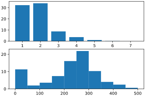

grabbed Pog’s Strava for Dec 2019, not sure if all rides were uploaded. Nice example for zonal distribution vs actual power distribution. So much coasting with these guys. Will be interesting to see how McNulty trains this year. Should be his first base period with ISM as coach.

Is he anywhere hilly? Can’t really help but coast when going downhill.

12/2019 → Slovenia, Monaco, Spain
But this is not unusual, all those Andorra/Girona/Monaco based pros have huge coasting bins in their distributions.

January 2020, that’s probably where the serious training starts. Nice to see ISM’s handwriting in this distribution
