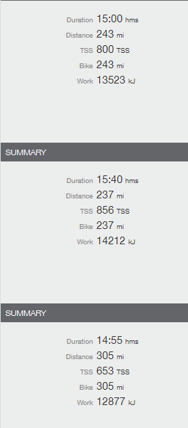

Gotta fuel for the work! Doing 3k kJ day after day requires that you wrap your head around nutrition, both on and off the bike
For me, the fueling is most important during hard workouts and because of overall volume
My last three weeks look like this from a kJ perspective. It is important to fuel both your workouts to help complete, but also intelligently fuel the rest of your day. For me, being this high on the weekly caloric burn, I find not only my workouts, but also my quality of life, suffers greatly when I’m not fueling at the right level and with healthy options
