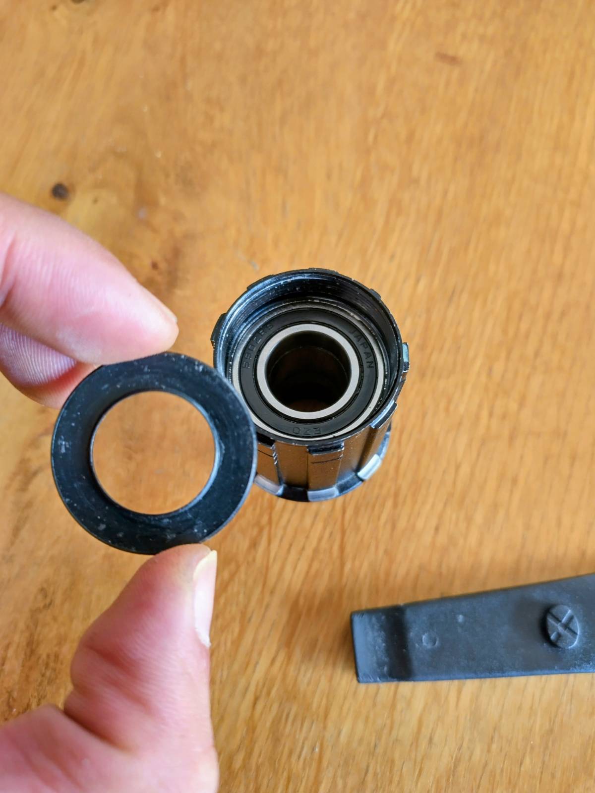

Sorry to reply to an old post but I just serviced by Hunt 4 season Gravel wheelset V1. The rubber cap can be easily pried off with a tyre lever. Hope this helps anyone who is facing a similar issue.

Doing one right now (which has unsurprisingly failed). Easy enough - cover off, circlip out, push bearings out from behind. Think they’re 6802’s or similar, a very standard bearing anyway.
