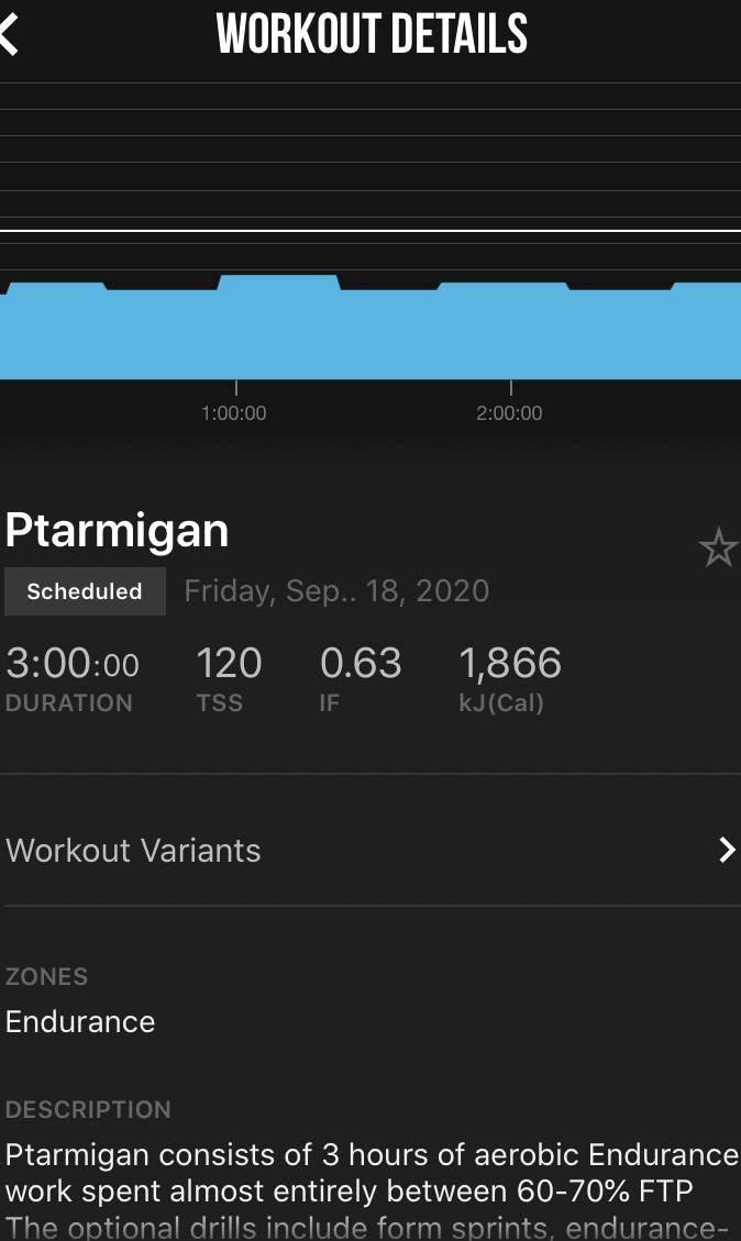

The Ptarmigan rides are good for this! Mostly Endurance with Ptarmigan +1 being a Tempo ride. My favourite endurance based series for 3hr efforts.
