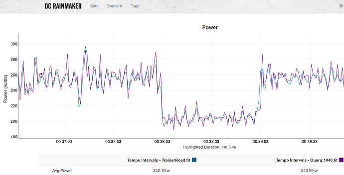

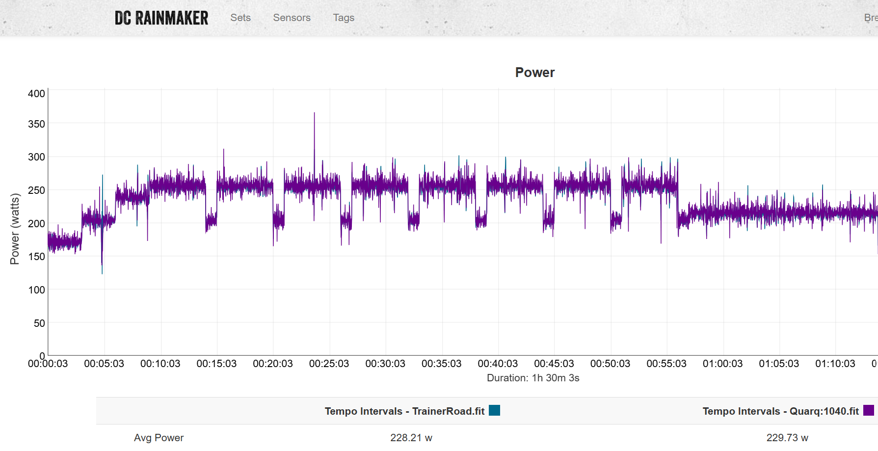

I use @dcrainmaker ‘s analyzer tool - Basically I had it pretty good with my TacX Neo 2T, but I replaced it with a 3M that’s now reading 10 or more watts low in certain scenarios, but only off 3-4 watts in others.
Example with my XC Bike Quarq vs. the old Trainer:
