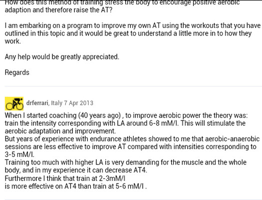

From the training topic here’s what the doc said:
Ferrari literally saying to improve ftp (AT4), train at or right under it (2-3 mmol, or sweetspot). Too hard training (above 5mmol) can be harmful even.
