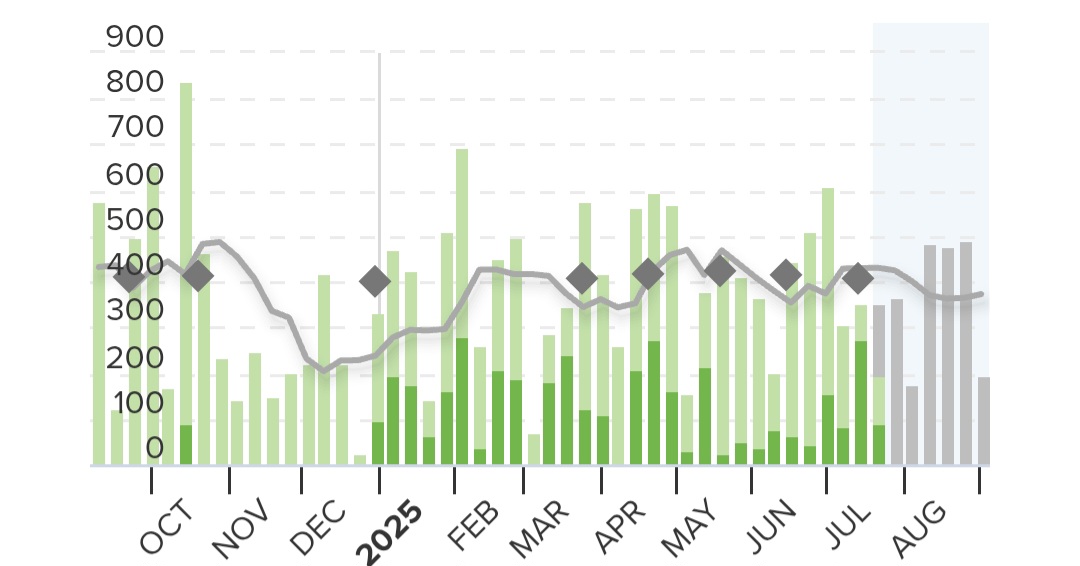

Here’s my recent chart coming from 2 weeks off the bike in Feb
What did you get?
