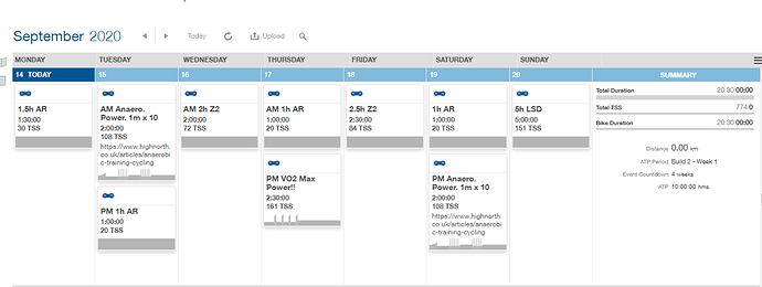

How did you 5w/kg+ riders make it there?
Yeah, that is a staple of my training!!!
Here’s my strava if you want any ideas :+1:t2: :+1:t2:
Great insight @d_diston. Thanks for sharing! I’d love to do a program like that. Mat Hayman did a very similar training set up preparing for Paris Roubaix. Easy endurance session in the morning and then a more targeted interval workout at night.
Thanks @Charlie_Botterill … it seems like the addition of Endurance at the end of the session is the way to go! The General Build HV program has quite a few Endurance extensions on the end of the interval sessions and now I know why! I might look at extending those Endurance tack on’s even further to see if I can get to 12-14hrs a week which is just inside the realm of capabilities for me whilst also juggling family life and work life. 20hrs a week is only possible over summer holidays!
