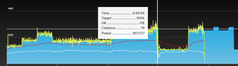

Today it was worktout “Three Sisters -1”. I was motivated, I was fresh and well recovered. Everything was good. Workout consists of intervals at 9 mins with 3x 2min U and 1min O. After first set I was smashed. After beginning of second set I was on the floor….
I cant believe why I’m struggling with this so badly. I can do sweetspot and vo2Max/anaerobic much easier.
My max heartrate is around 182bpm. My threshold HR on a VERY good day based on a 20 min ftp test is 172bpm. As you can see on my picture I peaked at 178bpm on my 3rd “Over” in my first set.
In my own opinion I think I’m good at following my plan, so I would really hope I would automatically get better at these workouts, but something is holding me back. Last “successful” OU threshold workout I did was “Anna” here it is “only” 6min per interval: 2x2min Under/1min Over. Here I peaked at 174. I guess its the same as when I look at Three Sistsers on the second O. So my problem is the 3rd UO. Heartrate just keep on climbing and I pop.

Only thing I noticed, is you cadence looks a bit low at 79. Maybe trying to get this up a bit might help?

I think the 79rpm was when I almost “died” in the last Over. The interval set was at 95rpm avg.

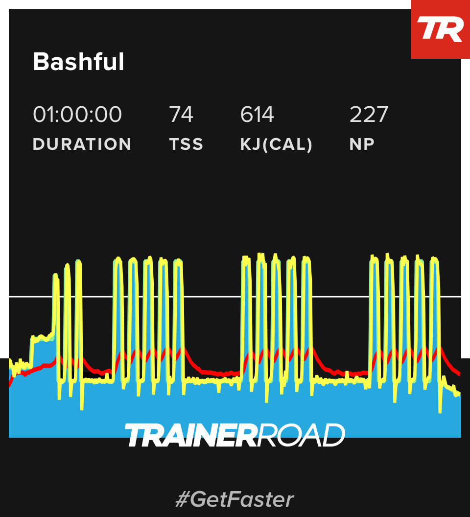

Only did first Vo2 workout this week. Went from 1.0 to 4.6. This was rather “easy” for a vo2 workout I think:
And also did first anaerobic Workout. This week From 1.0 to 7.
So I have only been doing SS and Threshold work until now and have quite a few failed OU workouts in my history hence I write here and ask for others experiences with them. If they really are supposed to be a pain and only achievable on an extremely good day or perhaps AI FTP detection are not working for me?
