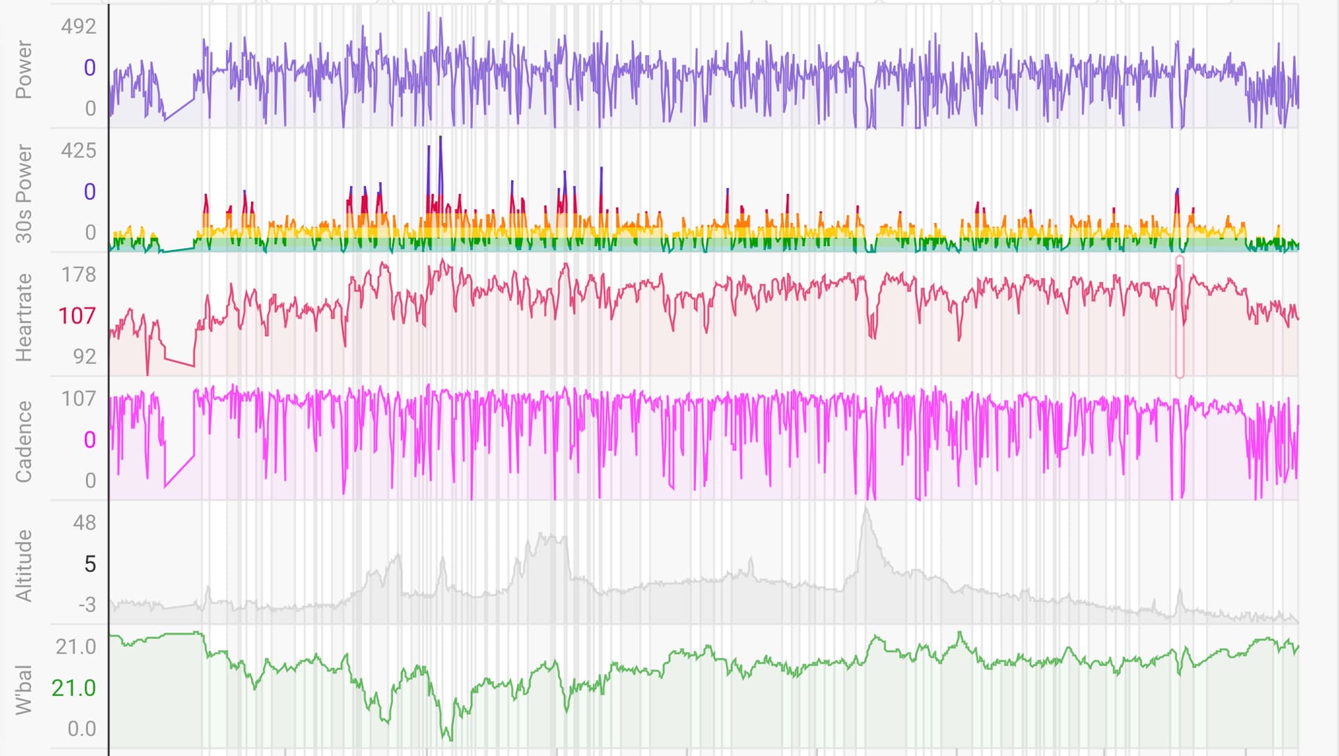

I feel like my FTP did not go up all that much but I sure raised my endurance power! Last Sunday was the last day of the plan, of course I did not stick to recovery and went on a ride with a much stronger friend. The ride was 5h, to my surprise I nearly smashed my all time best of 3h power - I had 230w avg, my PB is 234W from a road race years ago. I was 10kg lighter back then so it’s not a fair comparison, but getting so close to my best endurance power is very encouraging.
