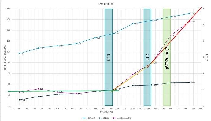

39/f been training most seriously and consistently over the past 9ish months using a mix of TR and then a coach. After my A race (Oregon Trail Gravel Stage Race) I found myself recovering and thinking of what is next. I decided to have a lab test my vo2max and lactate thresholds to have a baseline so that I can see how my training is helping me get faster and become a better athlete.
However, I am a little confused by what I am seeing and what I am hearing on the TR podcasts. They gave me my LTHR and VO2Max as well as my MAXHR and then calculated 4 zones.
I am looking for someone to help me understand this graph in a way that helps me apply it to my training and set my zones in a way that will allow me to be the most productive in my training. I have heard so much about LT1 and LT2 but am unsure how to pull those directly from the data and understand how to apply them to my training. I also am a little shocked at how low my maxHR is and wondering if anyone has advice looking at my data of which energy systems I should be focusing on training to bring my threshold up and to help my body clear lactate faster (my 4min recovery only cleared 0.6mmol but I was clearing 0.3mmol when in active recovery earlier on)
I am moving shortly and will be living in a place where most of my training will be on the trainer due to harsh winter conditions. In order to get myself set up on a training plan, I want to be specific about what and how I structure my training and am looking to the community for help on interpreting my data.

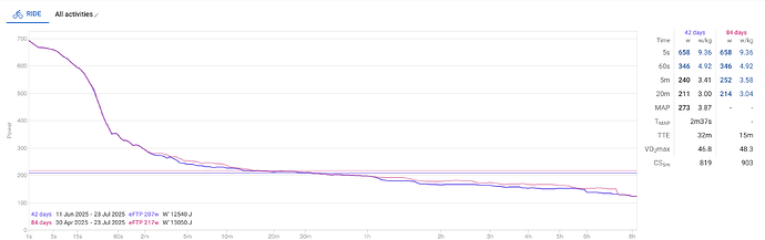

Can you show your mean-max power curve for the past 90 days?

My basic interpretation is below. I just re-plotted the data to power and used a simple graphical method to estimate thresholds.

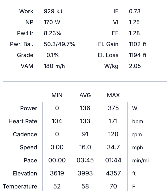

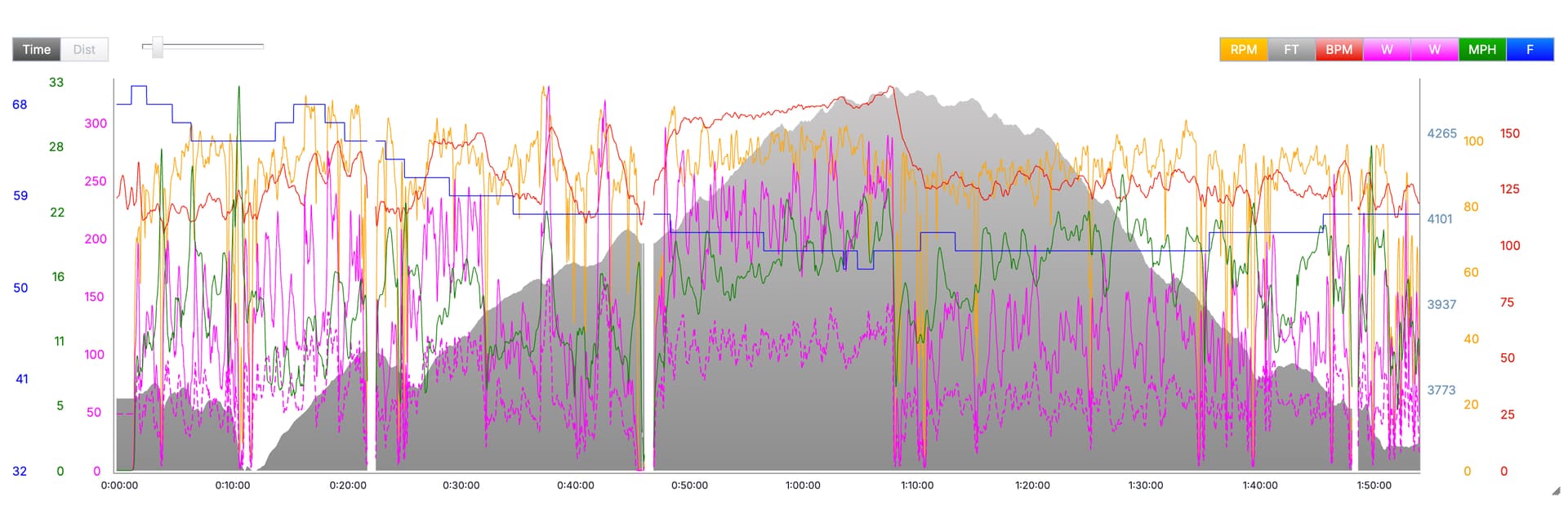

Actually @GarageLab I think I found what you were asking for. Here’s a bit more data!
This is interesting. I would have thought your FTP would be higher from the lactate data. From power modeling, your FTP is about 200-210 watts.

This was the protocol and the data from my most recent FTP which my coach set my FTP @ 210w.

So, I think the lactate test helps confirm your performance during the race. The lactate data isn’t really sufficient to make an LT2 estimate, I think.
In my opinion, your power data is better than the lactate data. You could get away with not testing and just analyze power in the future.
