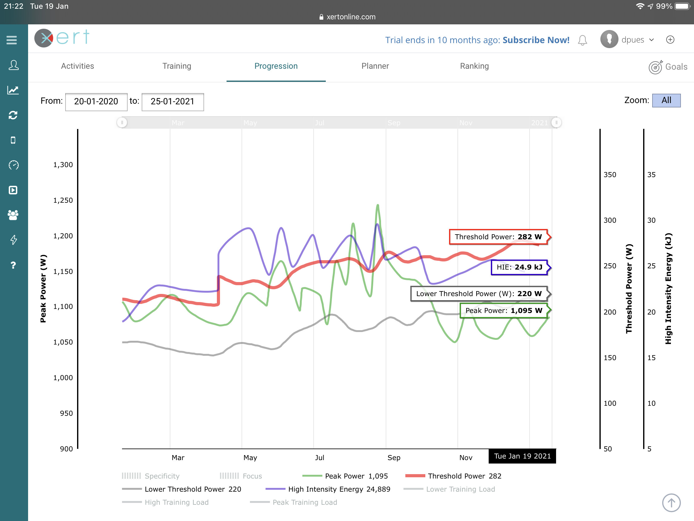

Another data point - I was looking at my progression in XERT which tells me that I may actually still be progressing, despite struggling to maintain my FTP via the TR ramp tests. I don’t know much about Xert and I just have it set to pull my workouts from Strava - so not sure how to read this graph. I just see that the yellow line (threshold power) keeps moving up. I also don’t know if any of this can be trusted. Anyway, this makes me wonder… is the TR FTP telling me the right story? TR ramp tests are at a plateau, even declining somewhat, while here I still see progress :-S. Anyone using Xert or has experience with it to tell me what I’m looking at is still progress? Why would my TR FTP stall, while this keeps showing progress?

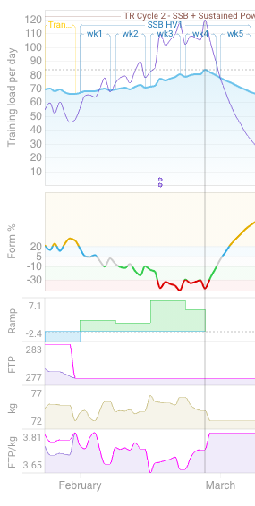

So… I’m almost 4 weeks into SSB HV1.
First graph: daily workout sessions along with my morning RHR → details in data set below, as well as by week
Second: Fitness/Fatigue/Form chart from intervals.icu
I have swapped out a few scheduled rides by some outdoor rides (road and MTB) - green bars.
Last Saturday, I have replaced a 2h SS session by a 3h Endurance session (Big Mountain).
I am also doing functional and core strength work 3x/week and daily 15 minute yoga sessions for mobility and stretching.
Some thoughts/questions/notes:
  • I think I’ve been overdoing it a bit by adding those outdoor rides as these have added quite a bit of TSS. Last week I even hit a TSS of 945! I’m worried I may be digging a hole here for me, however…
  • despite overshooting my target TSS, my RHR is only slowly creeping up, which is expected given the gradual increase of volume. I don’t see signs of overtraining (yet).
  • decoupling for all my rides has been minimal - mostly between -1% and +1%, even my outdoor rides and the 3h endurance ride.
  • as sessions build up throughout the week, my RPE for the same target power increases, as well as my HR/pwr ratio, until I hit a rest/recovery day, after which this drops again.
  • I have noticed on my outdoor rides, that my RPE has gone up compared to before starting SSB HV
  • I definitely feel pretty flat at the moment, ie most power above FTP seems to be gone (this became quite clear during my last MTB ride).
This weekend, I may do 1 or 2 more rides, which will overshoot my target TSS once again, before having a deload/recovery week next week. I’m very curious to see where my FTP will be following this recovery week…
Anyway, I just wanted to share where I am at at the moment. I welcome any advice, suggestions, feedback, comments. Thanks!
