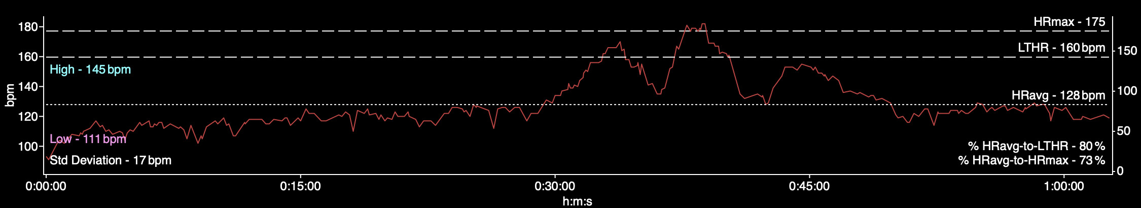

With all due respect to the post above, because bad data could be the root cause, I would report to your doctor just in case. I’ve had two incidents, one about 3.5 years ago and another a couple months ago. In both cases I believe the HRM, as explained below. Reported both to my doctor, we did some tests after the first incident and nothing found.
First time was January 2018 and I was on 20+ minute descent before a 2.5 hour climb. HR and elevation on the chart below… hit 186bpm while not pedaling at about 9 minutes into the ride. My observed max on many rides, where I sprint after a long threshold effort, is 175bpm.
It happened at the beginning, and lasted about 6 minutes total. Had no idea at the time, only saw it after the ride. This was a hard 2.5 hour climb at upper tempo / lower sweet spot, the rest of the HR data looks normal.

Definitely some anxiety and excitement and adrenaline. Because I didn’t notice high HR during the ride, I didn’t attempt to confirm the accuracy of the reading. It is possibly a bad HR reading from the Wahoo TickrX used on the ride. However on mid-winter days like that (cold and dry) I use electrode gel.
The other incident was this summer, following a hard 12.5 hour week - my usual max is ~10 hours - this was a Tuesday recovery ride at 40% FTP ramping up to 50% and then short 3x3-min tempo at 85% FTP:
HR was a little high at end of 1st 3-min interval, dropped quickly during 3-min recovery, jumped above max during 2nd interval, and HR returned to normal on the 3rd interval. About 5 minutes total of abnormally high HR.
When it happened, I cross-checked HR on my Apple Watch and it was showing the same HR readings. So in this case I’m forced to believe the Garmin dual HRM strap was accurate.
