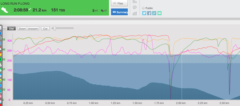

Still look at the graph: why is my HR 10 beats above threshold going downhill and I’m not out of breath !? Early HR is higher than once I do mile repeats and 100m sprints!
Second graph shows same behavior until i stopped and tried to count my hr with finger; it went normal afterward matching RPE and pace.
