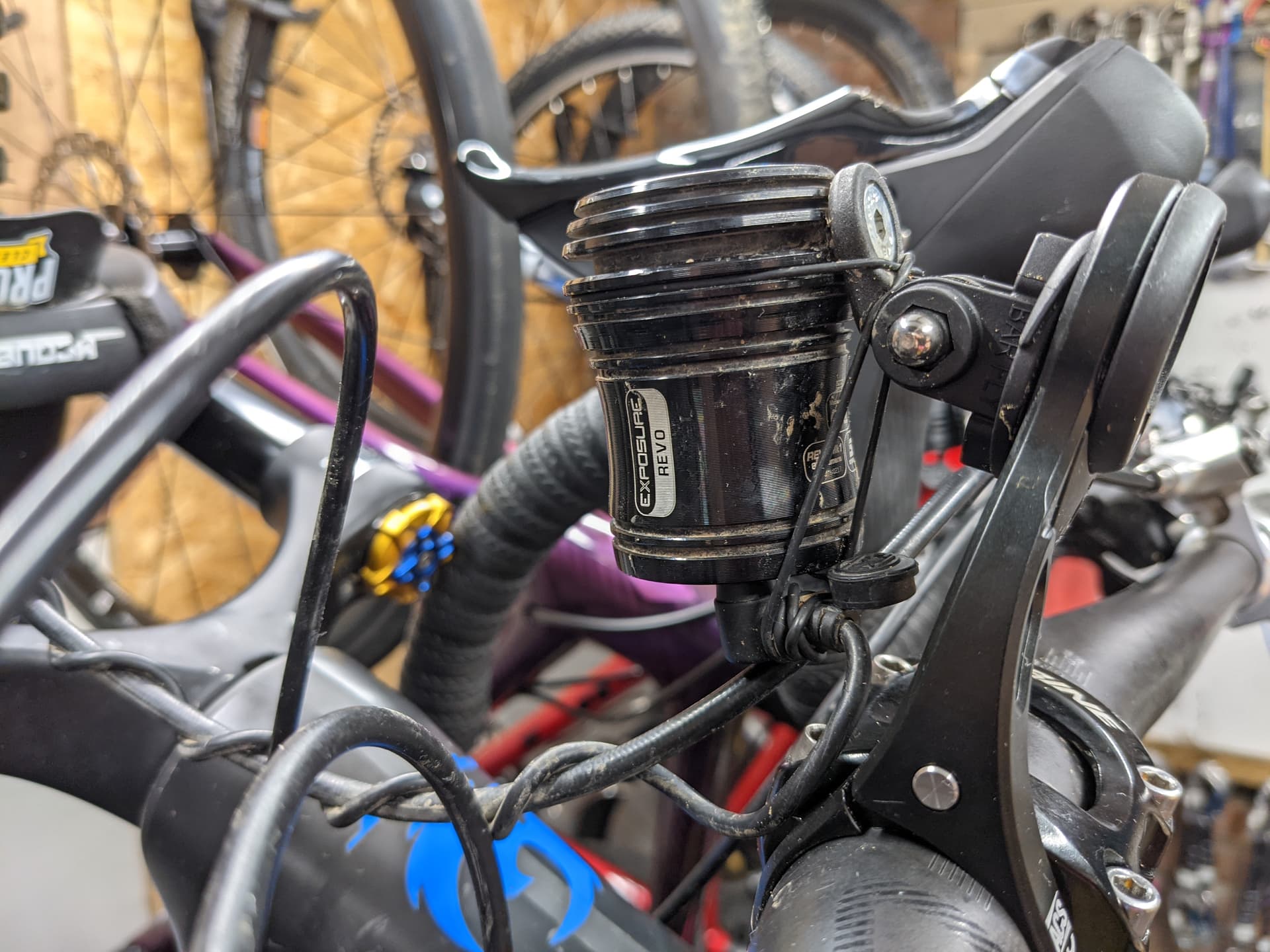

Exposure light household here!
I run two Stradas on different road bikes (good cut off beam to avoid blinding drivers, whilst not being STvZO it’s still pretty good).
I have a Revo on my winter hardtail, attached to an SP dynamo hub, and have a Race on the full sus for night riding. These are backed up with either a Joystick or Diablo (mounted on helmets). I also have a Link Plus for commuting (allows me to be seen rather than lighting up the road).
In terms of your use, I would probably recommend a Strada as the more trail oriented lights will blind oncoming traffic unless you point them right down. Pair it with a Diablo for great off-road lighting!
All of my lights are mounted upside down on the same mounts shown above or on the Exposure helmet mount.
Link Plus and Diablo helmet mounted.
Exposure GoPro mount on the underside of a Garmin mount.
Strada ready to use on the wife’s road bike.
Revo mounted with a non-QR mount on my hardtail (as the light is very rarely removed!)
