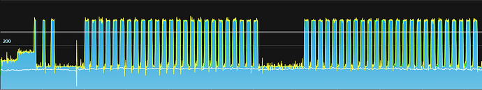

Here’s an example of Gendarme +3 where I did 50 x 30/20s at 120% of FTP.
Keeping your trainer in a low gear, as you mentioned, makes a huge difference, and I didn’t have to pace these efforts at all. I just let ERG do its thing, and the effort felt perfect by the end of each set. :sweat_smile:
I’m not interested in trying to manage 50 x 30/20s manually.. :face_with_open_eyes_and_hand_over_mouth:
