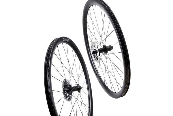

I have a set of Hunt 35 Carbon Gravel X-Wide and really like them. 31mm ext width, 25mm int width, 35mm deep, 1465g, and a lot less expensive. I know some people aren’t a fan of the hubs but I can’t tell the difference from higher end wheels. They have a sale right now, too, so these would be 20% off list price.

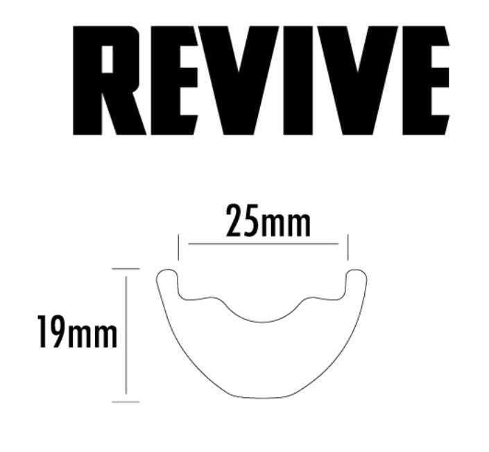

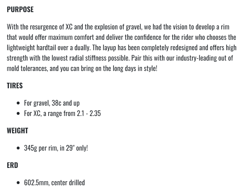

I also went with the We are one wheels for a new gravel bike. Everyone I know who has their MTB wheels absolutely loves them. Cool that they’re made in BC as well.
What do they weigh and what is the external width of the rims? Seems like they don’t put those specs out there.
External width 31mm by my calipers

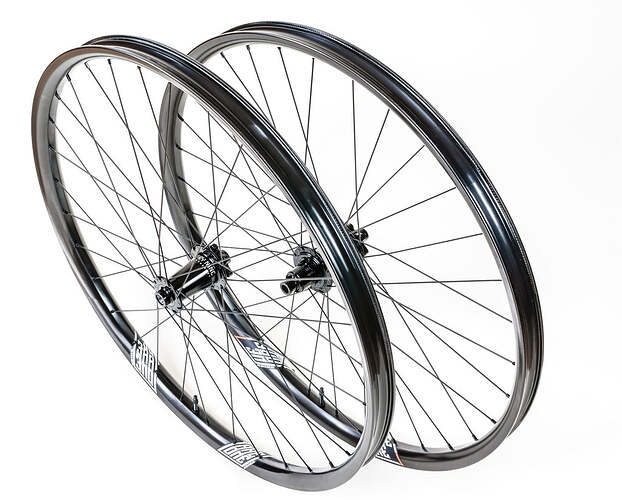

We are One Revive Rims, Berd Spokes, DT Swiss 180 (MTB Hubs - XDR)
Front - 518 g
Rear - 610 g
I have them mounted up with Vittoria Airliner Light Inserts and Conti Race King 2.2’s for my lightweight / distance / climbing wheelset for my XC bike. I don’t hammer on them, but they’ve held up to multiple descents of Leadville’s Powerline, Columbine, and Sugarloaf, albeit on a 100/100 FS XC Bike.
