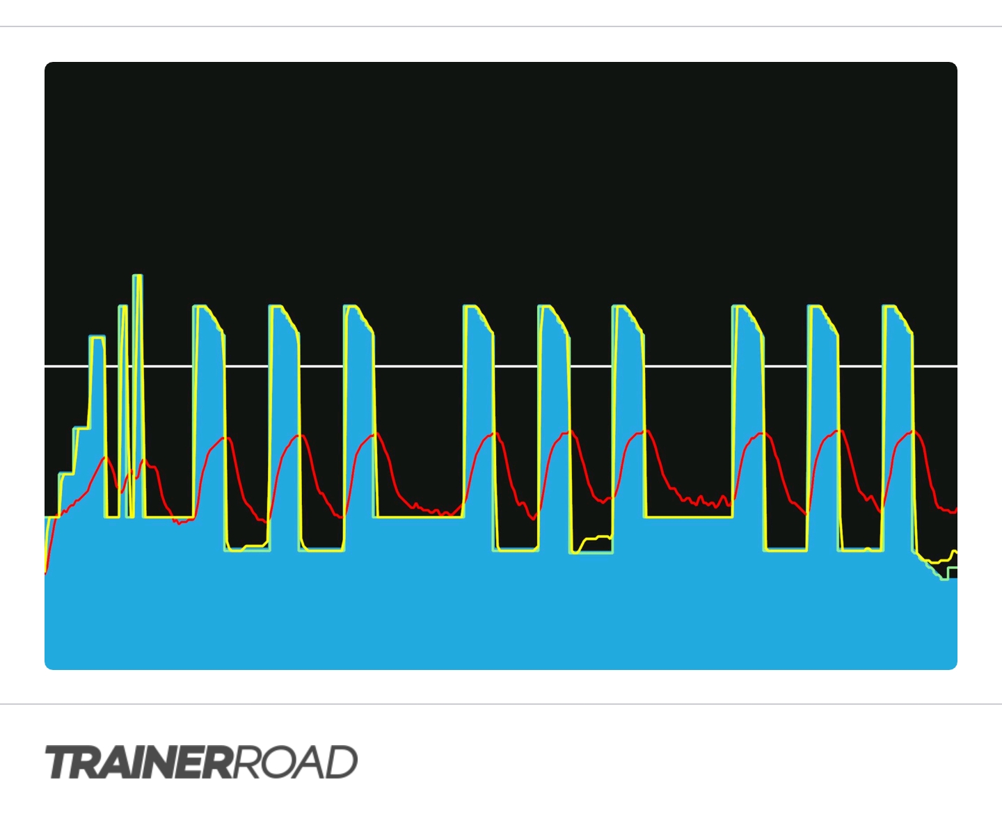

I’ve sometimes thought the Trainer Road interface on V02 max workouts would be more useful if it represented the recommended power peaks as zones with an upper and lower line. You see a lot of people (and I have done it too…) fixating on making the power line match the graph, even though the on screen coaching is very clear about V02 being a range with variability from one rider to the next.
Or perhaps the power number on the interface could have a toggle or secondary piece of information that tells you what percentage of FTP you are working at right now. The mental math is a bit much when I am also busy sucking wind and praying for death to release me.

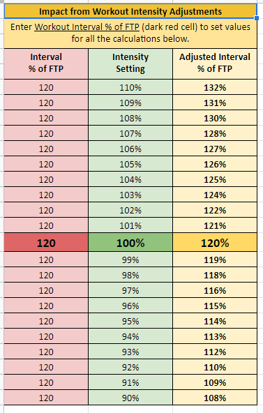

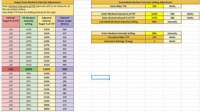

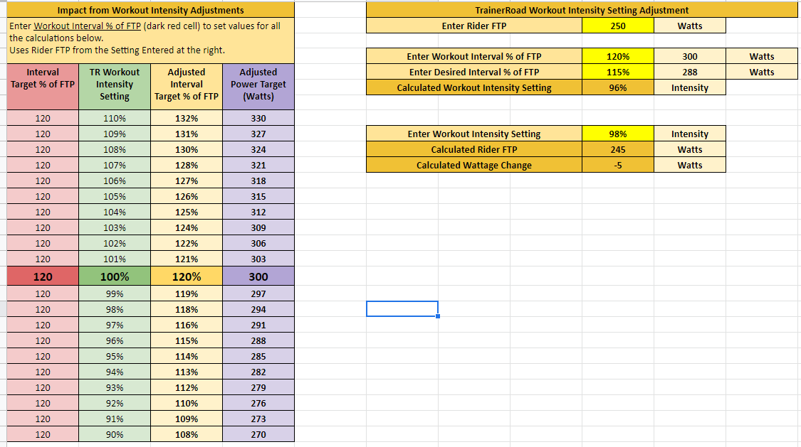

Here is my cheat sheet, with % of FTP focus. I could add a column for actual FTP%…

Isn’t that what the 3rd Col is ?

Yeah, I meant adding actual wattage target. Bad wording on my part.
Like this:
See the “General Cals” tab.
