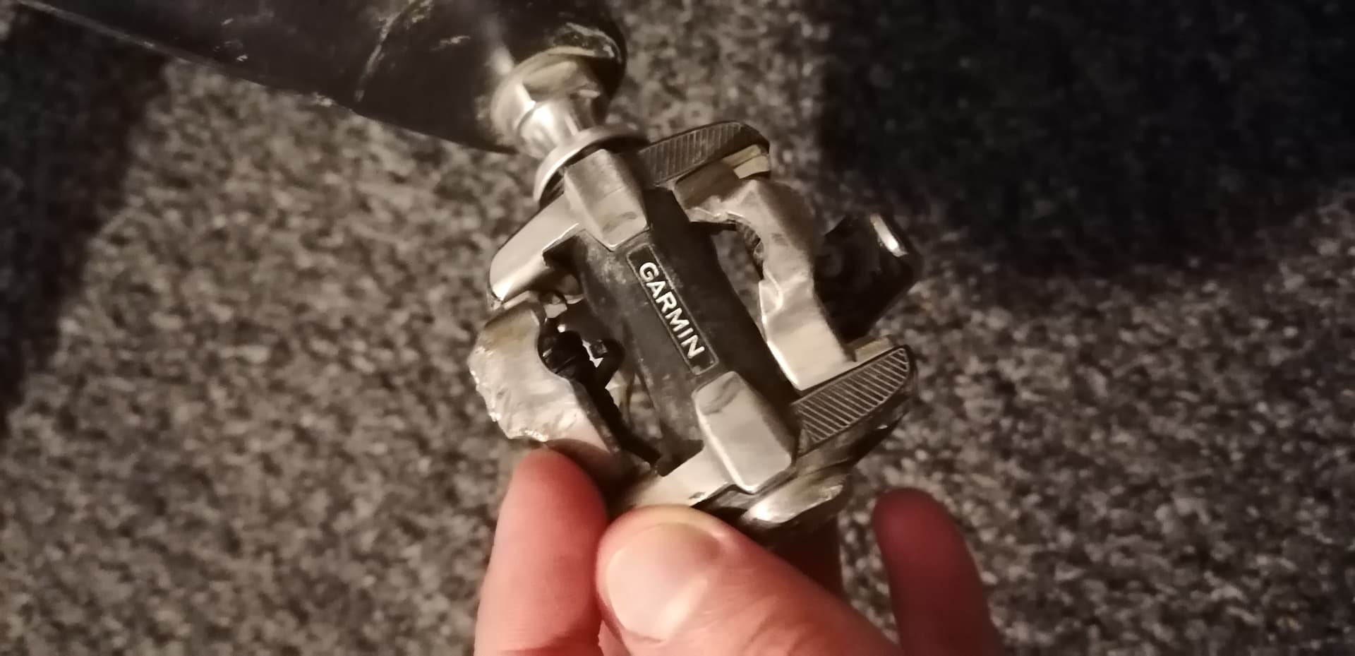

Has anyone had any issues with breaking the XC pedal body or is it just my luck?
I’ve had these since late Jan. Probably ride mtb only once or twice per week since. I’m completely new to mtb so I ride pretty chill and I’m 65kg so i wouldn’t say I’m particularly abusive to these.
Never had a pedal break on me before! You can see it cracked clean off where the adjustment nut is
Wow! Hope you are still in warranty. I’m just shy of 90 kgs and have had no issues (gravel/road/trainer). I know DesFit put them thru their paces. Hope Garmin takes good care of you.
