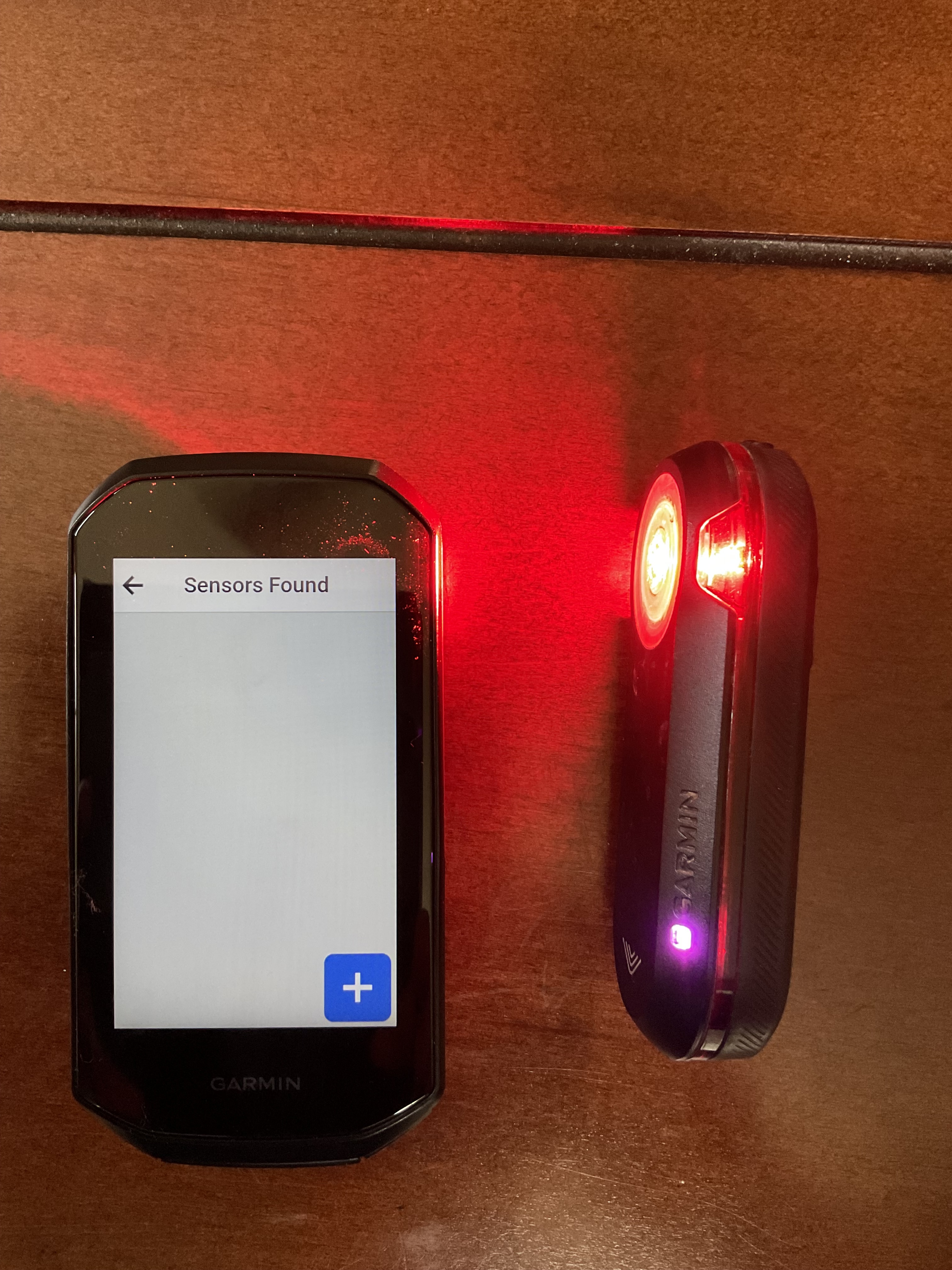

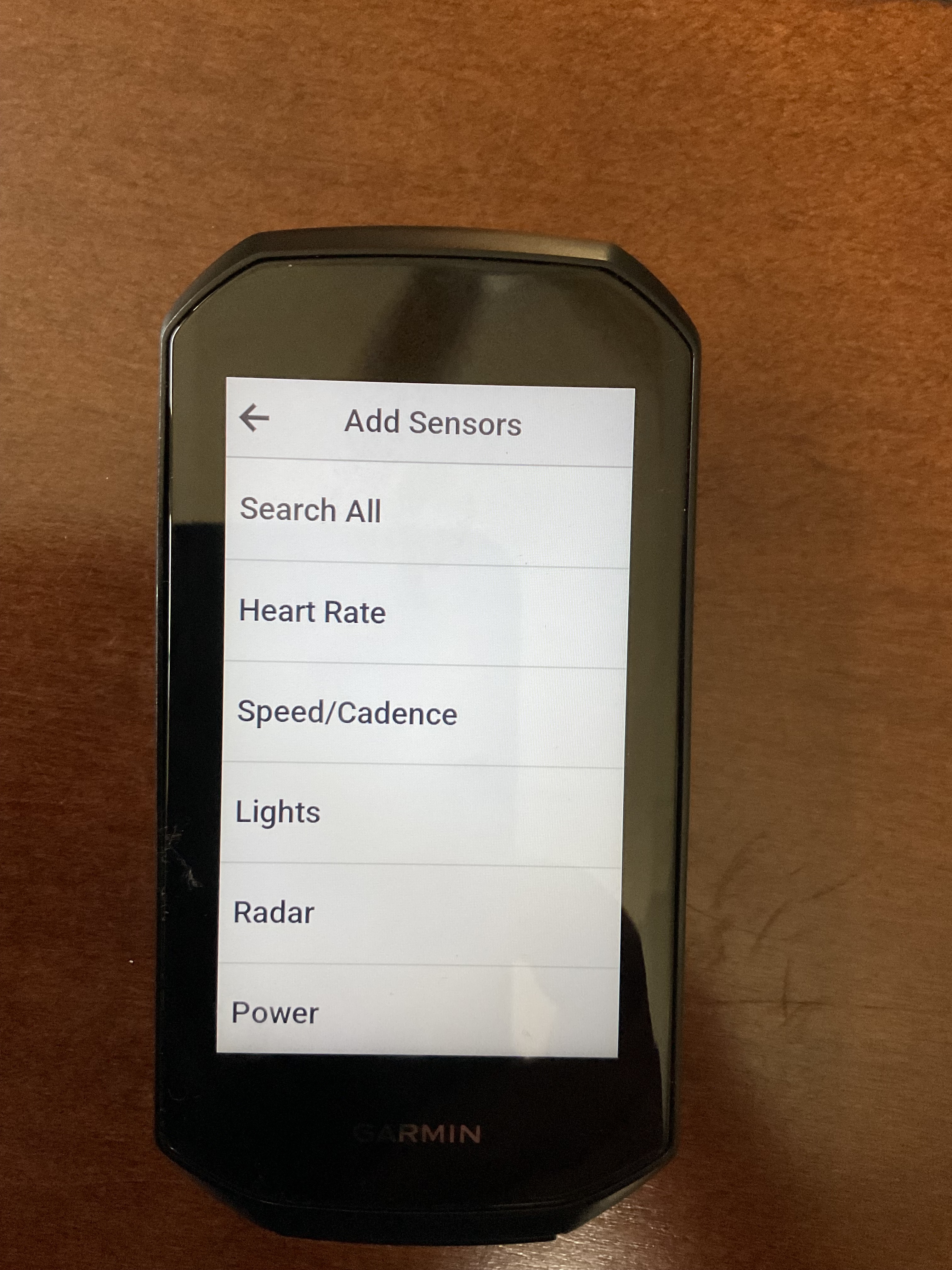

I’d first drill into the Radar sensor and tap connect or something.
That’s what you’re seeing above. The result is that it says ā€œsensor foundā€, but there is no sensor listed.

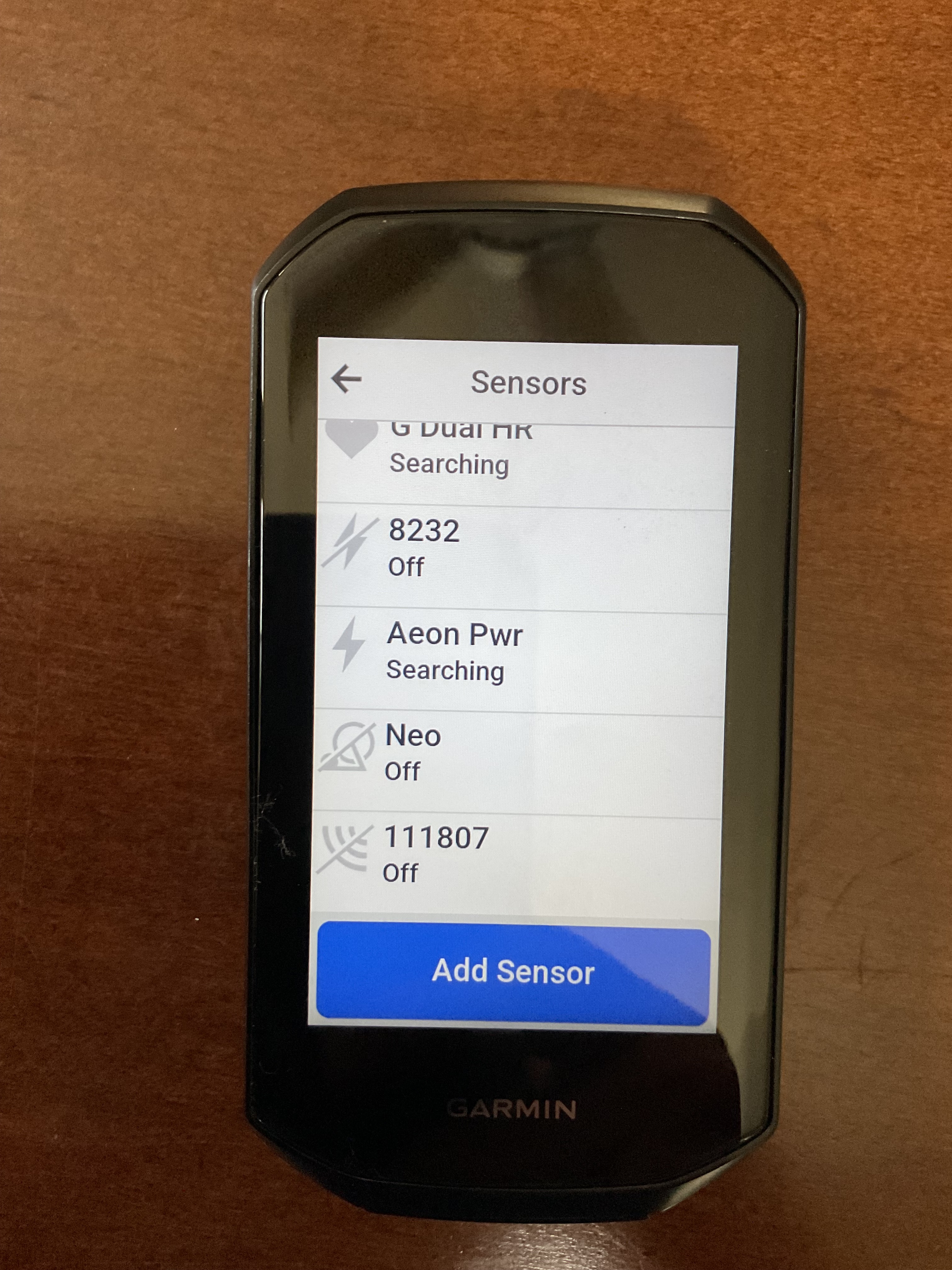

delete the light sensor and the radar sensor, and try pairing again. Then full reset/delete. Something weird is going on.
Yeah. Just praying I don’t have to do the full reset. Let’s see if anyone else has solved it.
if you already haven’t, try the Garmin forums
I put search all and the varianin apiring mode and didn’t had a any issues with the rapar, running latest fw on both
Bit the bullet and did the reset. It worked, but the true good news is that while it deleted my activity profiles, the cloud remembered them and I reapplied, so the only device I had to add was the Varia, which worked! :sweat_smile:
