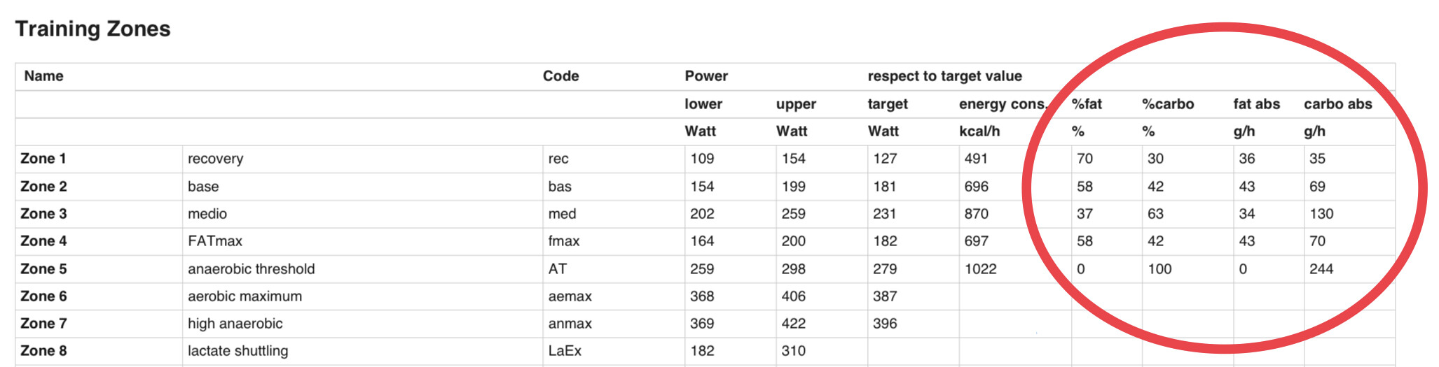

I’m not sure what your opinion is, if any, of INSCYD testing, but I went through one of their metabolic tests ~4 years ago and part of the output was the chart below.
Not sure if it’s accurate, or representative, but it was actionable in that it set my FatMax range. I believe there is some controversy or misunderstanding(s) on this board as to what that term means … but the coach I worked with at the time used the middle of my FatMax range (I believe it was 185W) as the number I should be around when I went on long (4-6 hour) endurance rides to maximize benefit while minimizing recovery needs.
Thoughts?
EDIT:

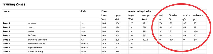

I also received this table. Again, unsure of its utility other than how to apply FatMax to training. I suppose it could directionally help you understand/visualize how much you should be fueling during a race at an anticipated intensity.
  1. Incyd’s conceptualization of physiology is incorrect.
  2. There is no evidence that basing training off of the maximal rate of fat oxidation is beneficial, nor is there really any reason to think it might be.
Sorry, but you asked!
No need to apologize. I’m looking for accurate information, not what I want to hear.
