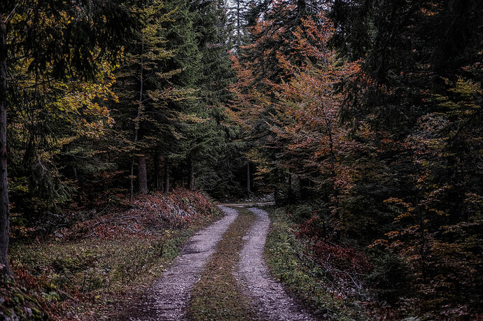

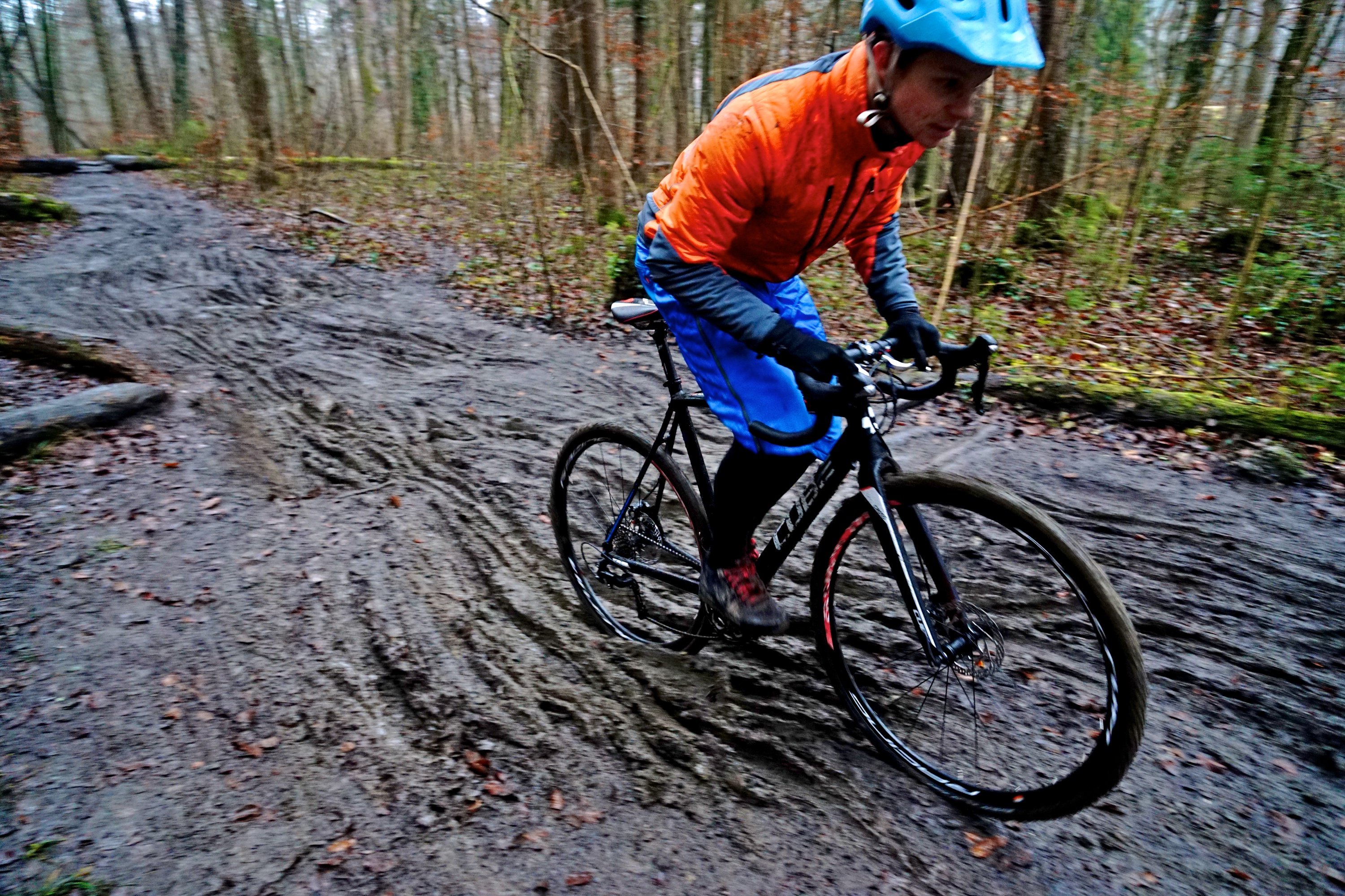

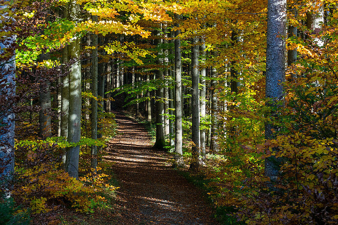

To make it more tangible. We talk about such surfaces:

However when its muddy, I find wider tyres to be quite a bit slower than typical cross tyres.
