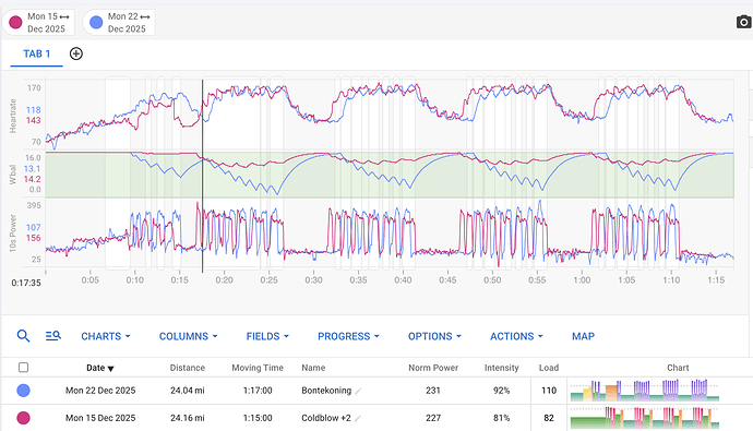

It is really interesting that you compared it to the Coldblow +2 effort from a week ago because I genuinely found Colblow to be significantly easier than Bontekoning. I uploaded a screenshot from intervals.icu comparing the two and while the average HR and Power overall were very similar the impact on wbal was categorically different. Bontekoning intervals took me nearly to zero and the long recovery intervals were perfectly timed to fully recharge. By comparison, the Coldblow wbal indicates I was actually recovering during the last interval of each set… which matches with how it felt.
Not sure what any of this really means except that I probably need to HTFU on my hard intervals.
