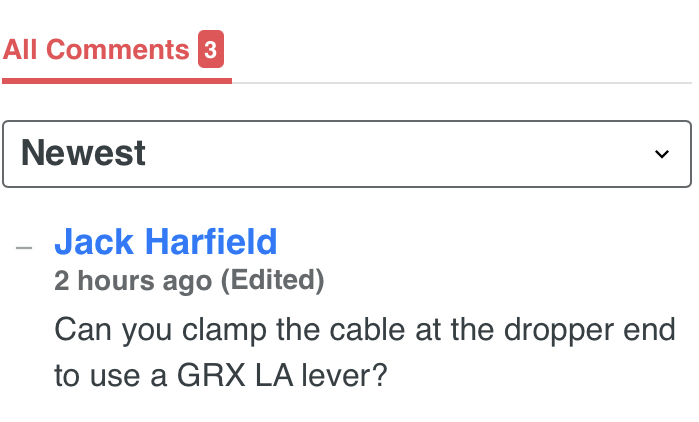

This is the key question for me:
I don’t know why you couldn’t, that’s exactly what the lever is made for.
Ah, yes… that is an issue for many Shimano setups.
Oh, does the shimano lever have a way to clamp the cable? I use a SRAM left shifter, which requires the cable end to be at the shifter rather than the post. I assumed shimano was the same.

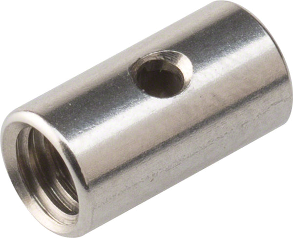

  • No, and it’s not necessary with this dropper.
  • There is a cable clamp (circled in red) that clamps the pure-cable end of the cable. This is a common option with a variety of droppers. As such, it should work fine with the “roadie shift lever” style dropper actuator setup.
Edit: see Chad’s post below, looks like the needed part is included so it should work out of the box.
I just read the instructions. Looks like the “cable clamp” you circled doesn’t clamp the cable the way a KS cable clamp does. Instead it just fits over the cable end in order to enlarge it, the way OneUp/PNW do it for example.
So my read is no, this won’t work out of the box with a mechanical left shifter. You could probably hack it with the KS clamp though—might have to file it down a bit to fit (I did this with a OneUp post on my gravel bike).
Ah, OK. I was assuming the set screw was on the underside. I’d have to check sizing, but wonder if a typical clamp would work in that situation?
Pretty sure it would. Enve leaves the sides open where their “clamp” is so width doesn’t matter.
