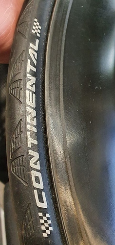

That is the wheel itself, does it look like the smooth braking surface then?

Do the pics above look like the smooth surface - 99% sure, as it looks like textured did not appear until about 2017.

I still own two pairs, both of which were warrantied out and received the updated brake tracks. Don’t worry though, one of those replacements was absolutely tortured to failure (in normal riding conditions) the other was just cosmetic blemishes. The wheels in your pic look as new as they were advertised to be, ride them and enjoy.
