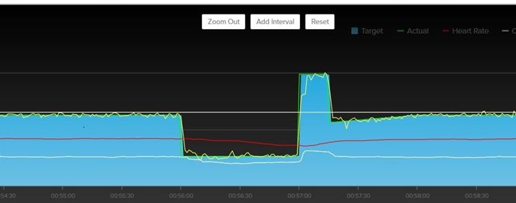

I have the same experience, my Direto is pretty good at repsonding but as a mountain biker I train in a low gear (36 x 18 mainly). See below it going from 40%-150% ftp in approx 3 secs.

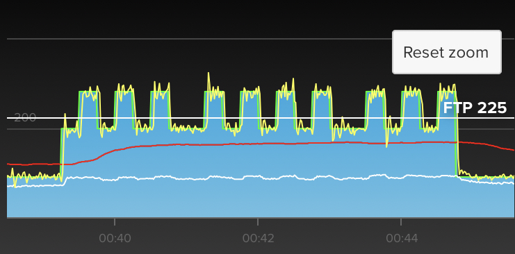

I’d not done short intervals yet in my Direto until yesterday. Here’s 15/15s from Flume. Responds pretty well. I have a Direto from 2018. The response time seems to be fine. Not sure why Elite would have changed the algorithm in later models…
SOrry to bring this up, but I’m a Drivo user.
That response is TERRIBLE!
Look at the massive overshoot at the start of the 4th rep, and then the oscillation all the way through. The reason then needed to update this is because it was really poor.
It works fine for me. You don’t need a perfect square edge power profile to have an effective interval.
