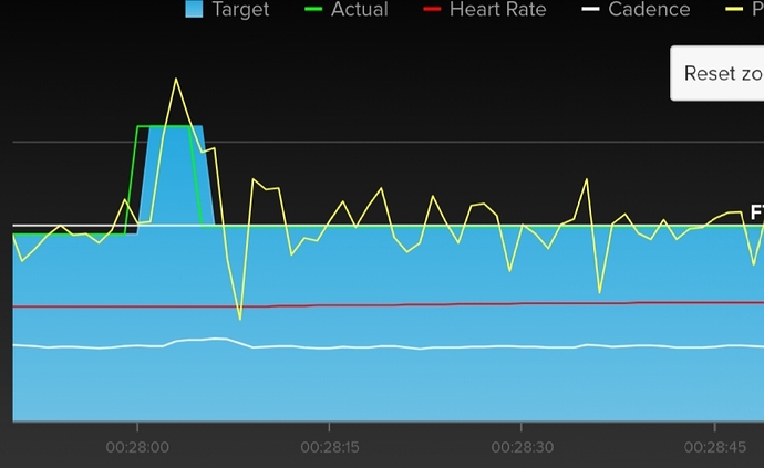

Here is my Jepson from earlier last year, on my H2.
Pic of the first set:
I am getting a decent overshoot peak and overall “area” of the kick is more or less on point.
Keep in mind that the precise values here probably don’t matter as much as the general spike and recover demand, so try to get close, but don’t sweat the fine numbers.

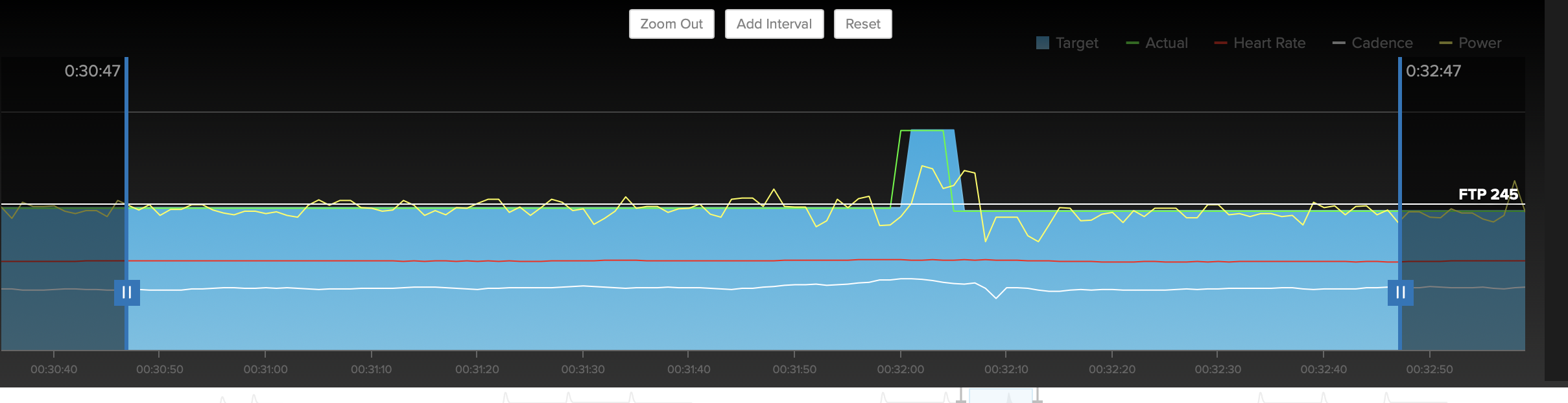

Jepson, Tacx Flux S:

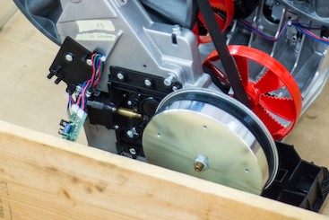

I’ve only had mine two months, wonder if there is a software update for yours? One other thing that might be worth checking is if the adjustment mechanism on the resistance unit is sticking
Elite-Visit-1-of-1-8 (2)

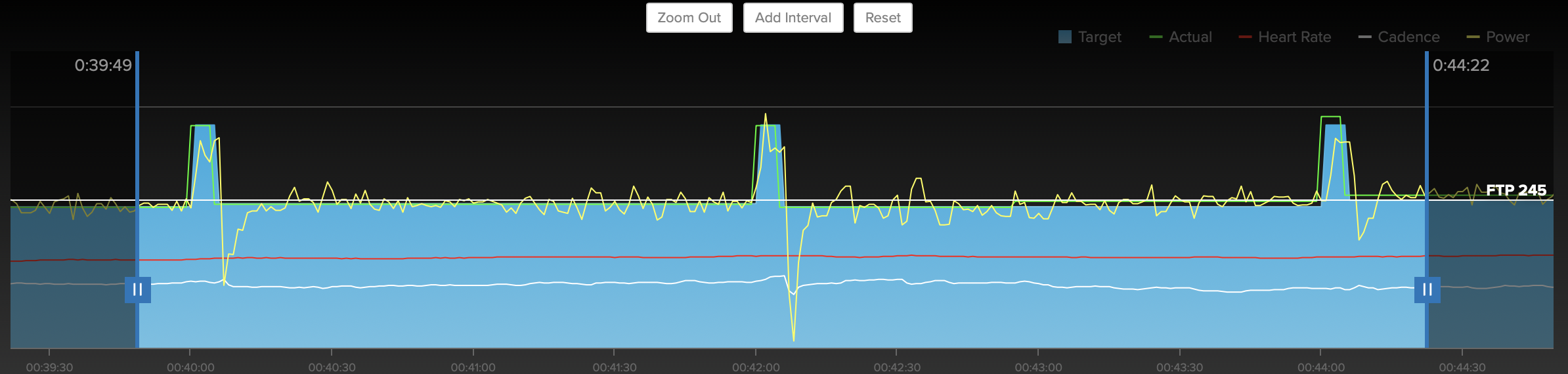

Wow, mine look nothing like that. The first set was the best of the workout. I get a peak close to the target but not at/over. The third sprint in that series peaks over, but not by much. The second set you can see a similar thing happened, even when going up to 105% workout intensity in the final sprint. The single sprint was the worst of the bunch, a full 60W low at its peak, not much over FTP, and not the point of the workout I felt like.

For comparison these are 3 sprints in jepson from my workout this morning. I guess we are in the same spot. Not super excited about carpathian peak +2 on Saturday.
