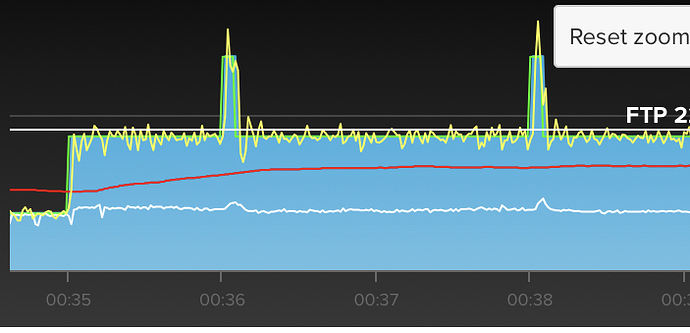

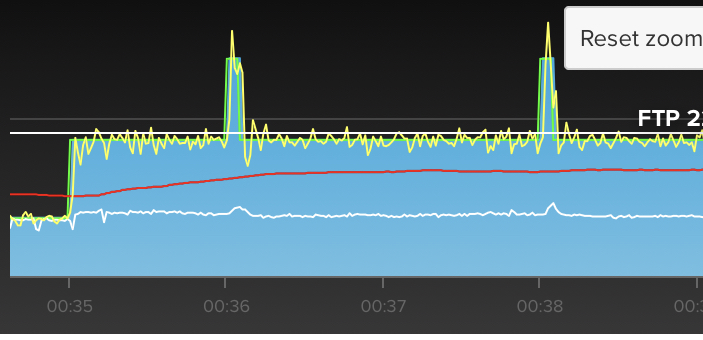

Here’s a few screenshots. I tend to use the cadence tricks Chad mentioned - slow down before the power step, then ramp cadence up to target over 5-7 seconds.
Those Jepson sprints don’t look too bad, I’d take them over what I was getting. And I think Carpathian Peak should be okay with much slower/longer ramps. They look a lot more gradual so I’m hoping the trainer can handle them fine.

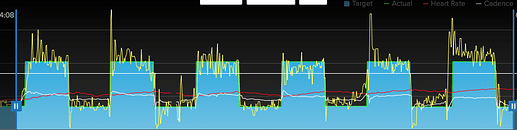

These days I switch modes to Resistance (aka slope) for anything under 90 seconds or so. Here is typical ERG behavior in 1 min VO2max intervals (this from Baird last year).
These intervals aren’t physiologically useless. But the combination of delay and response bias (in favor of keeping below target rather than above) means that almost every short ERG interval comes out below target, often 5%, sometimes more, and that’s a downer when you see it as a whole list, and can’t really do much about it. Adding insult is that the instructions are exhorting you to “get ready”, “hold your power,” etc etc, when in fact it is better to come into the interval below normal cadence as @DaveWh mentioned, and if anything go easier. If you actually hit it right at the beginning or slightly before, the Direto freaks out at the spike and drops resistance more quickly than it increased it, so you’re suddenly overspinning. It’s like dancing with someone who doesn’t know how to dance.

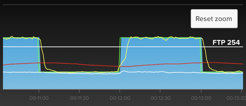

Here is a more recent set of same intervals and targets (Bluebell), where it’s easy to spot the two intervals in which I decided to give ERG one more chance:
Which would you take? The thing is, though I regularly go a little over target in Resistance mode (and deliberately on that last one, it feels if anything like less effort for a more satisfying result, because it feels like I can control it better – too high, back off, too low, a little more gas. In ERG it’s an out of control feeling that adds some mental frustration.

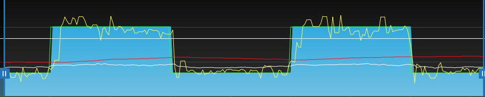

Here are some 30/30 intervals from Taylor on my Direto. Things are pretty tight.
Yes, small ring, middle cog on anything short. Often go to large ring on long easy stuff for smooth feel.
Looking at your cadence it seems like you stay slow well into the interval and wait until the Direto starts to clamp down and then try to match whatever its “slope” is – ie. rate of increasing resistance. I get best results when I do that too – usually. It’s a bit counter-intuitive – and also counter to TR instructions to pick your desired cadence well before the interval starts. If I do that, I get a pretty wild ride for the first 20 or 30 seconds :crazy_face:

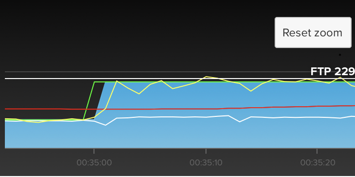

This my Direto on Baird. Looks very different to yours. There is the delay but not the same level and it seems to settle down. I use the little ring I the front for all my erg workouts.
