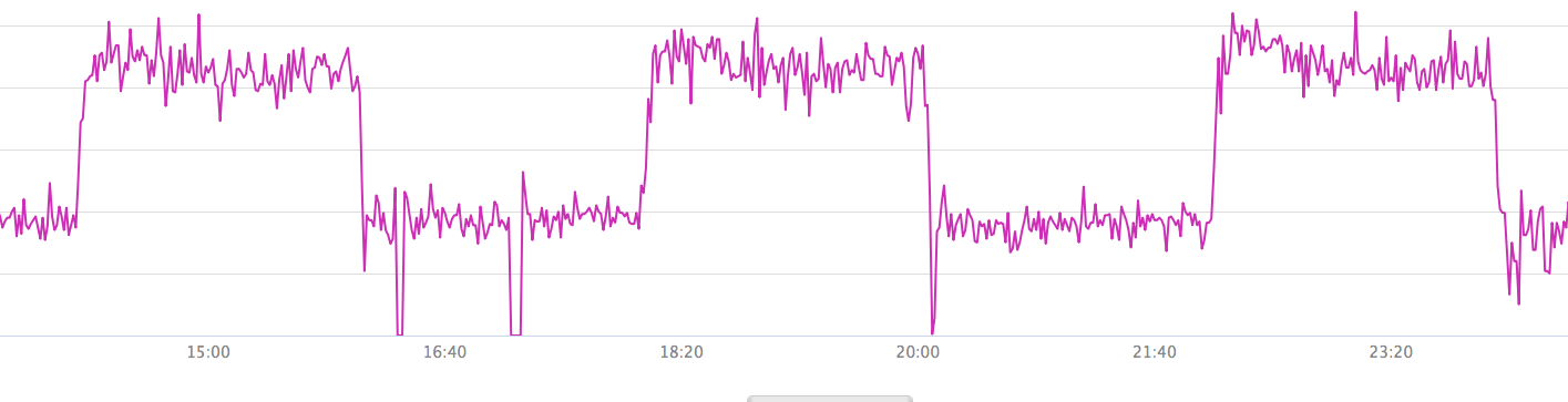

Last week I rode Dade -1 with my usual setup: Direto and 4iiii, Power Match on Auto, Erg mode. Here are the first three intervals:
I did all of the workout in the big ring except for the second interval where I tried the little ring. Like OP, there’s a difference in staying on target; unlike him, it’s the little ring that’s struggling! I clearly remember exactly what you see here in the second interval – the power staying consistently below target until the very end of the 2-min interval. I shifted back up and stayed in the big ring for the remainder of the workout. The big ring intervals were better, with an opposite tendency – a spike that later settled down. [Standard practice for erg is to come into the work interval at the cadence you want to use, but if I do that, power actually drops at the beginning of the interval and takes 10-20 seconds to get back up, so I took advice I got in the forum and now wait until the resistance kicks in and then I try to scale up with it – hence the cadence line here.]

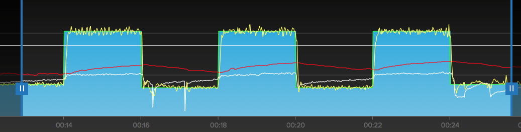

Yesterday, after my post, I re-rode the first part of Dade -1 again, to compare with the above. But this time I turned Power Match off and unpaired the 4iiii from TR, so TR was using only the Direto to measure power and adjust resistance. Way different result:
Not quite the phony boxes a Kickr can display, but as close as I’ll ever get. I believe these three are all in small ring but I forgot to make a note, so now uncertain. The Direto alone is not the wobbler.

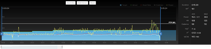

Simultaneously with this, I also recorded the workout on the 4iiii alone on my head unit. Since this didn’t go to TR, I’ll have to show it in Garmin Connect:
To re-iterate, this is just the 4iiii’s reading of the same exact intervals as the earlier graphic from the Direto alone, not a different ride. The initial surge – which I’m sure is real in some sense – is seen by the 4iiii, but not by the Direto, which is seeing only total power arriving at the trainer.
Since my 4iiii is left-crank only, it’s likely that a left-right imbalance in legs has something to do with this – weirdly manifested over time. I’m sure my left leg is weaker, but also that I tend to lead with it. So two different real time reports, one of them changing, gets thrown at Power Match and then thrown back to the Direto’s resistance mechanism – and sometimes, not always, the experience is weird too.
I also ran these two files through DC Rainmaker’s tool and re-confirmed that the 4iiii always reads appreciably higher than the Direto, a lot higher at 100 watts than at 200 watts – so that changes too.
