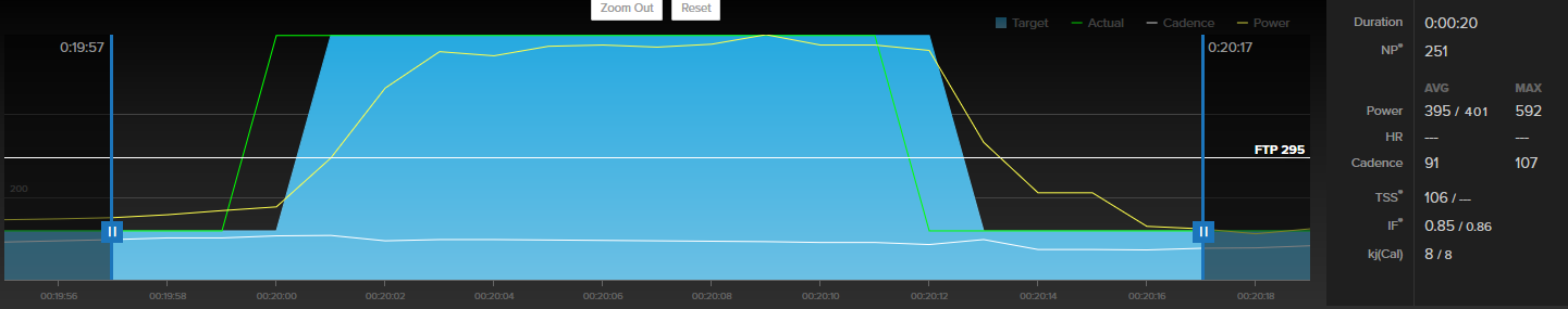

IanDarlington
  1. I am using a “Granny wheel”. Middle ring of triple and middle of cassette. Make that 39/15 or so.
  2. I am sure it is this slow. The Guy from the UK distributor said he could hear the stepper in the motor starting to respond as I described it, 3-4 seconds after the interval started.
  3. Also I am waiting for the feel of resistance. There is almost none if I start to push immediately. Also when the power is supposed to drop from 350W to 130W I can definitely feel the power is held on 350 for 3-4 seconds before it starts to transition downwards.
    4.The smoothing value seems to make no difference. I read a load on the Elite forums and I have tried 0 and 10 and 2 and 5. I think this is merely a reporting of the power rather than the actual power. I reset it to the original value.
I should emphasise it is not that I am looking at “TR averaging” but feeling when there is actually a resistance change. There is none for 3-4 seconds – then it responds… the transition… over 7-9 seconds.
Reading through some of the forums, here and elsewhere, I am sure people are finding differences over time. There was one where a Drivo 1 was responsive but a Drivo 2 was not. (Basically same internals I suspect).

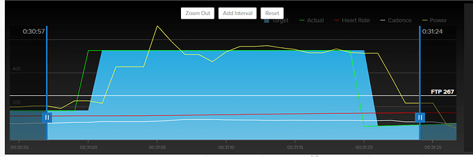

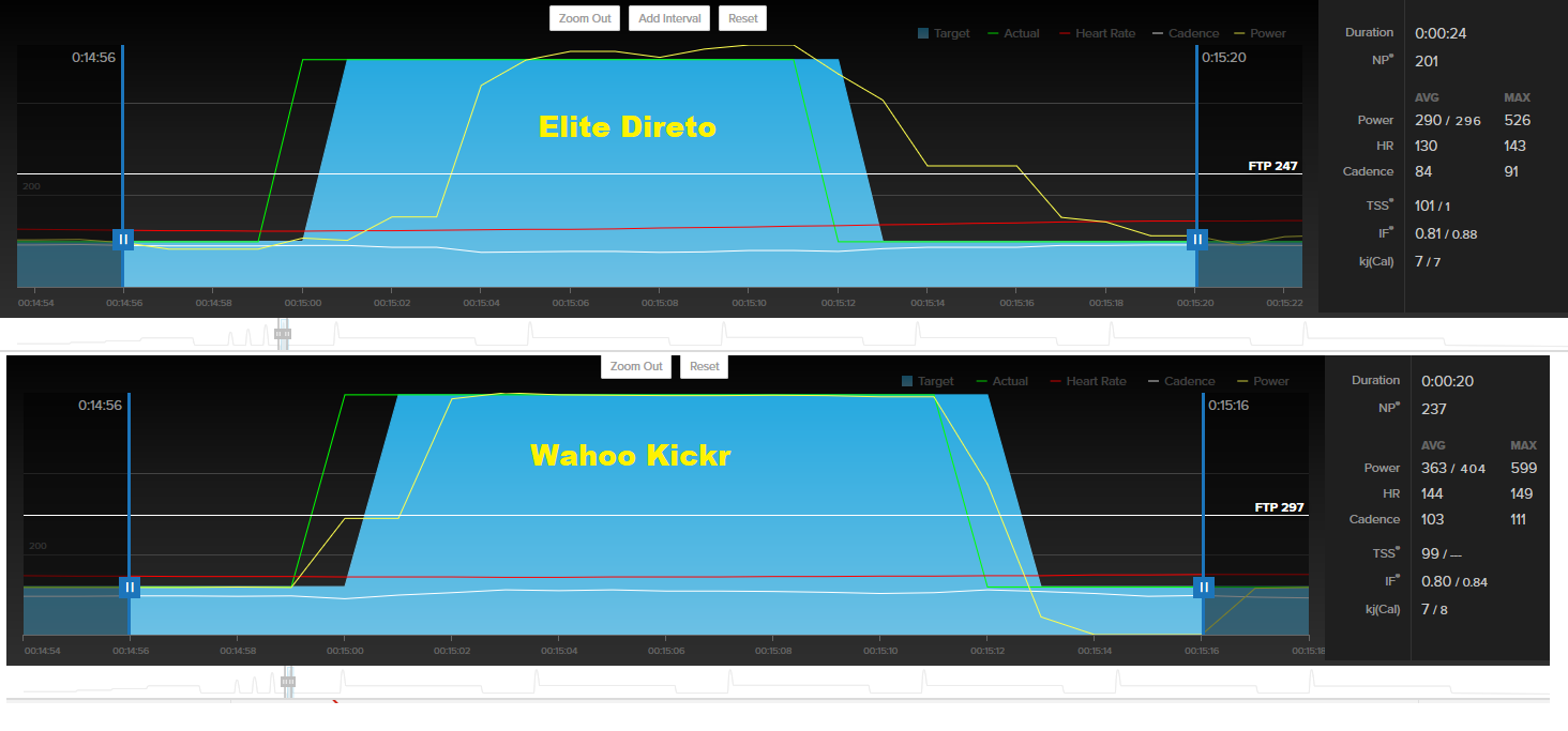

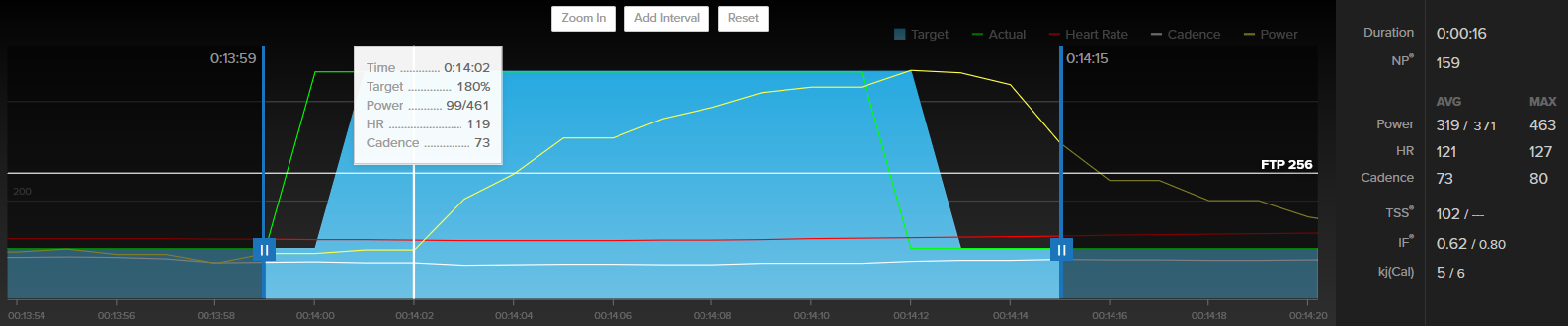

Just so everybody can see a visual representation of power lag here is the last warmup interval of the Clark workout. Top graph is the Direto. Bottom graph is the Kickr. Both workouts taken from random folks who made their data available on TrainerRoad. Thanks random folks!
The Direto ramps from 99 to 494 over the course of about 5 seconds.
The Kickr ramps from 119 to 595 over the course of about 2 seconds.
So there you go. I’m sure if we dig through more workouts we’ll find more examples but these two seem to be illustrative based on what I’m reading in this thread.
Here’s a Tacx Neo. Gets the job done in about 3 seconds.
Tacx_Neo
Brennus, That is really useful. Thanks. What it does illustrate for me is that this example Direto does not start to ramp up for 3 seconds after the TR signal and then starts to transition. Whereas the kickr stats its ramp up almost immediately. Also you can see how the Direto hangs onto its power after the end, whereas the kickr ramps down.
I am assuming that the curve represents the persons ability to put power against that increased resistance. This is where the problem lies for me… if you start too early you simply spin up and end up at 110rpm, in the higher power and have to manage your cadence down.
I also note that the TR signal starts 2 seconds before the segment, as reported elsewhere.
I’m just looking at Kickr, Direto, Neo, Wattbike, Vortex, couple other…
Seems like Direto is the slowest for sure. Kickr is the fastest for sure. Everybody else seems like they are in that 3 to 4 second range.

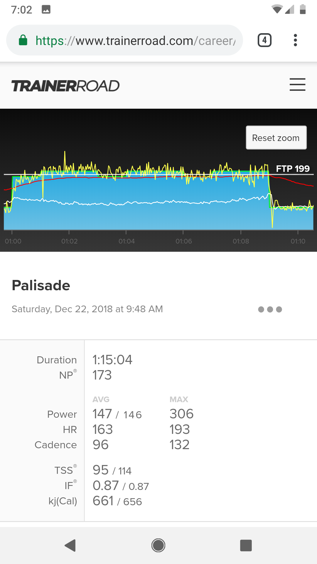

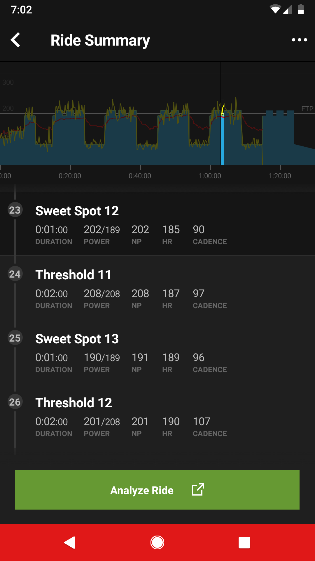

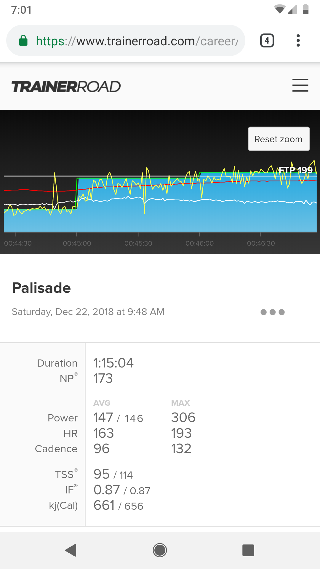

Just started using my direto on Thursday. Is what’s happening to me in these images just because I’m a newb to erg mode? Definitely a huge delay, like over the whole minute, never hitting the target.
I’m just annoyed that it appears as though I failed my last “over” even though I had some left in the tank and was ramping up cadence higher and higher with no resistance, consistently under target :rage: then other intervals (such as the “unders”) I’m well over!
Please help :pray:
I have a Direto and I haven’t experienced this before so I may not be able to help too much. Did you give it a spin down calibration?
Edit: Your issue isn’t a cadence issue but perhaps this may help out…
I did the spin down calibration 2 days ago. I should be doing it before every ride, correct?
Also, I have stages L/R power meter I use for my cadence and power. I wonder if I should disconnect that and just do the trainer since they appear to have the same numbers.
I will also trying turning Bluetooth off through my Mac and just using ant+ since that is what my heart rate is through. I want to try it a TR workout on my phone to see if it responds the same but my HR is ant+ and I really like seeing the HR data even though it doesn’t usually mean anything, heh
I’m not sure it would account for a full minute but in erg mode counterintuitive you sometimes need to slow your cadence slightly to allow the trainer to find the right level.
If you’re constantly upping the cadence it will also be constantly adjusting as well to try to compensate.
