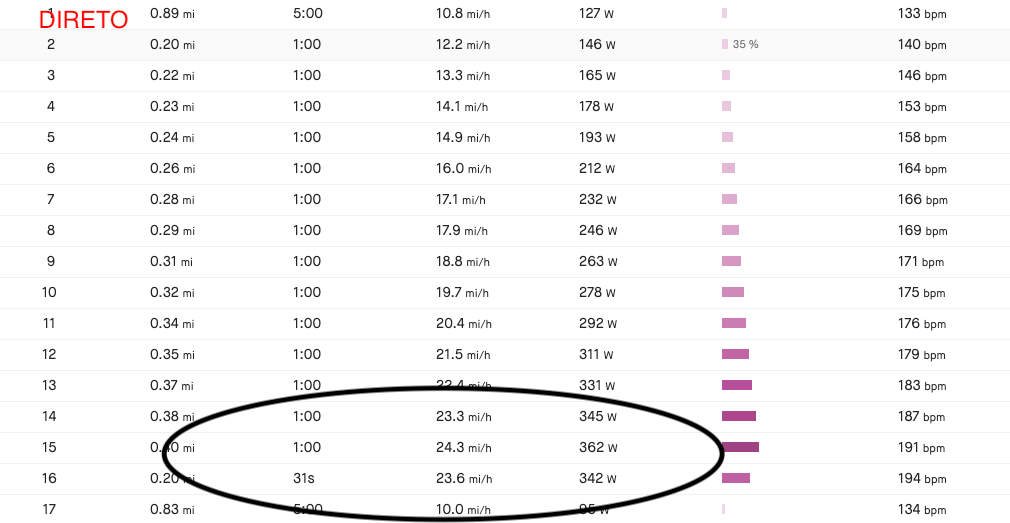

I’ve known about a significant power differential between my Powertap P1 (left only) power pedal and my Elite Direto trainer for awhile, and for today’s ramp test I decided to run both separately. My methodology was probably not ideal: I paired the power meter to my Garmin and hit the lap button for each step of the ramp (that cognitive load is worth a few extra watts, right?). I forgot to hit it at the most crucial moment near the end of the test, but Garmin Connect says my Max Average 1 min power from the power meter was 423 W (18:34-19:33) vs. just 368 W (18:28-19:27) on the Direto. 58 watts is a massive difference!

The photos show the steps for each file from Strava for comparison.
