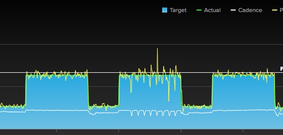

I have a Drivo and mine seems much faster than yours. Its a bit slower in power match than when just using the trainer alone. Small ring at the front does make a big difference. Attached Kaweah power matched with stages left only. Middle effort was out the saddle drills every minute (nasty Chad :slight_smile: )
Kaweah

BTW. I Did a workout. But before made my test. I did a “calibrate trainer” in elite app, after that click the “power capping / power smoothing” in elite app and started new workout in TR.
So now I have someting like in the picture.
Is quite better but still true is sentence that “for short intervals, the lag significantly lowers average power for the interval, and so it is always significantly below target”
