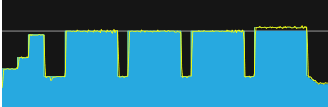

If you get through Lamarck when you’re well rested, and you feel decent during it, and you even increase the intensity of the workout and still feel great, that’s when I’d say it’s time to kick your FTP up a notch. Here’s an example:

Incidentally, I completed Lamarck +1 today, 5 x 10 mins instead of 4 x 10! I ended up completing all 5 of them above my ftp; 254, 254, 258, 257, 256. I may increase my ftp to 254 as this felt sustainable.
