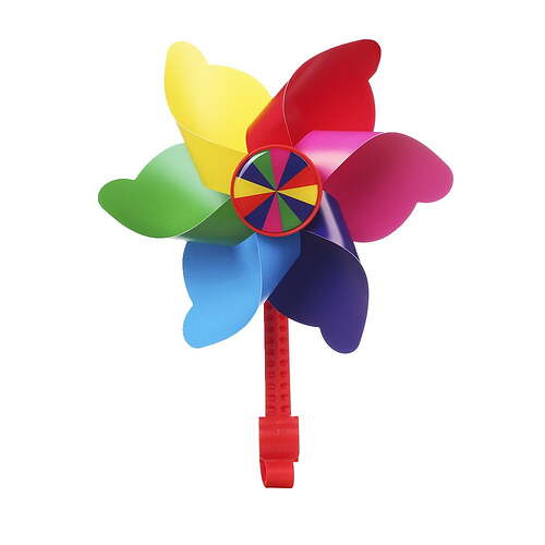

Perhaps a Pitot tube mounted to your head tube would help in this calculation.
That’s exactly what I’m looking for – thanks!
Only now to make it smaller…
