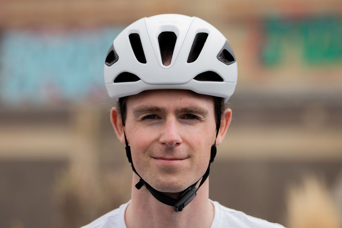

Decathlon Road Bike Helmet FCR

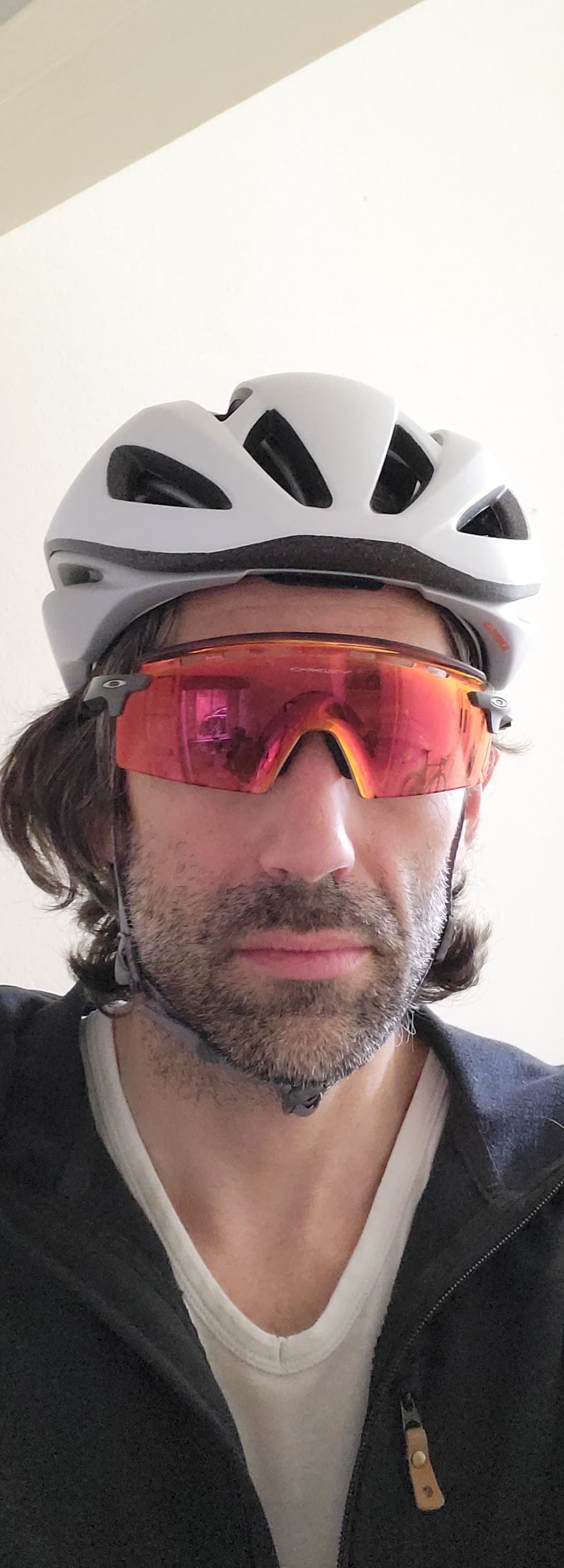

Doesn’t look or feel bad at all! Though I haven’t ridden with it yet
Giro Eclipse Spherical for reference
The Giro is 18g maybe 20g lighter, which I think is mostly due to the magnetic lock of the FCR
Edit; I used the FCR today, it was very cold, windy and wet today, so I can’t really comment on ventilation but the comfort was very good, didn’t even notice it was there at all. I had some problems getting my sunglasses into the sunglass holder but maybe that’s just practice before that I had a Giro vanquish and taking off the visor was frustratingly hard too
