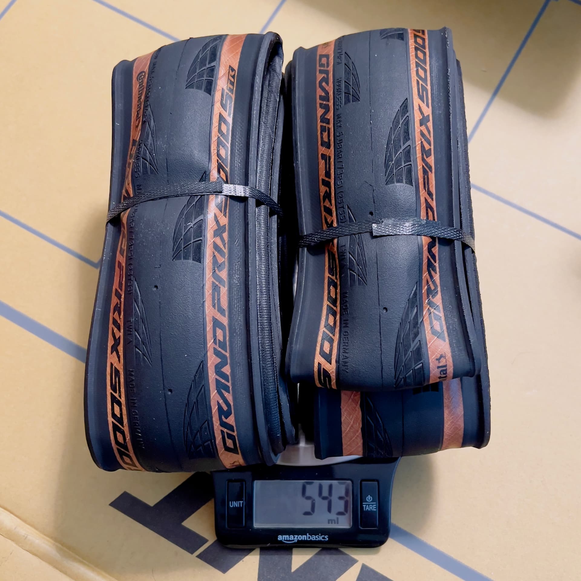

Just got my pair of 28mm. 7 days from Europe to US. Will mount them up with latex tubes first to give them a quick try.
They mounted up as easily as regular tubed clincher GP5000.
I got them to seat with a regular pump, very straightforward.
On 23mm internal, hookless Zipp 303S wheels, measured width at widest point after 24hr (with latex tubes at 65 PSI) - 29.6mm.
