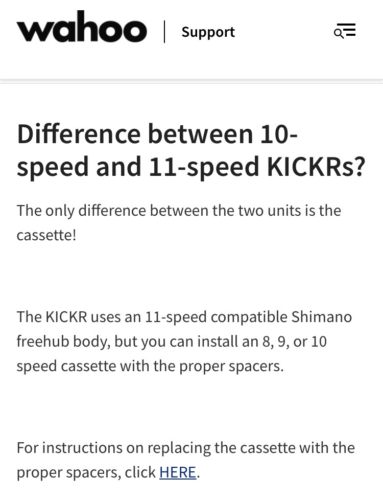

Wahoo says you can do it with spacers:
https://support.wahoofitness.com/hc/en-us/articles/204281874-Difference-between-10-speed-and-11-speed-KICKRs-

I’d bet good money that customer service rep is so young they’ve never even seen an 8 speed cassette. If the dropouts fit it’ll be fine. Don’t think that 8 speed chain is going to work though.
Wahoo would never say anything except that….but it doesn’t mean it still won’t work. They are just (rightly) protecting themselves.
Hmm…
Source: https://support.wahoofitness.com/hc/en-us/articles/204281874-Difference-between-10-speed-and-11-speed-KICKRs-
Maybe they think it’s an issue because that Trek is not compatible with 130mm hub?
