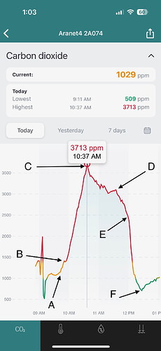

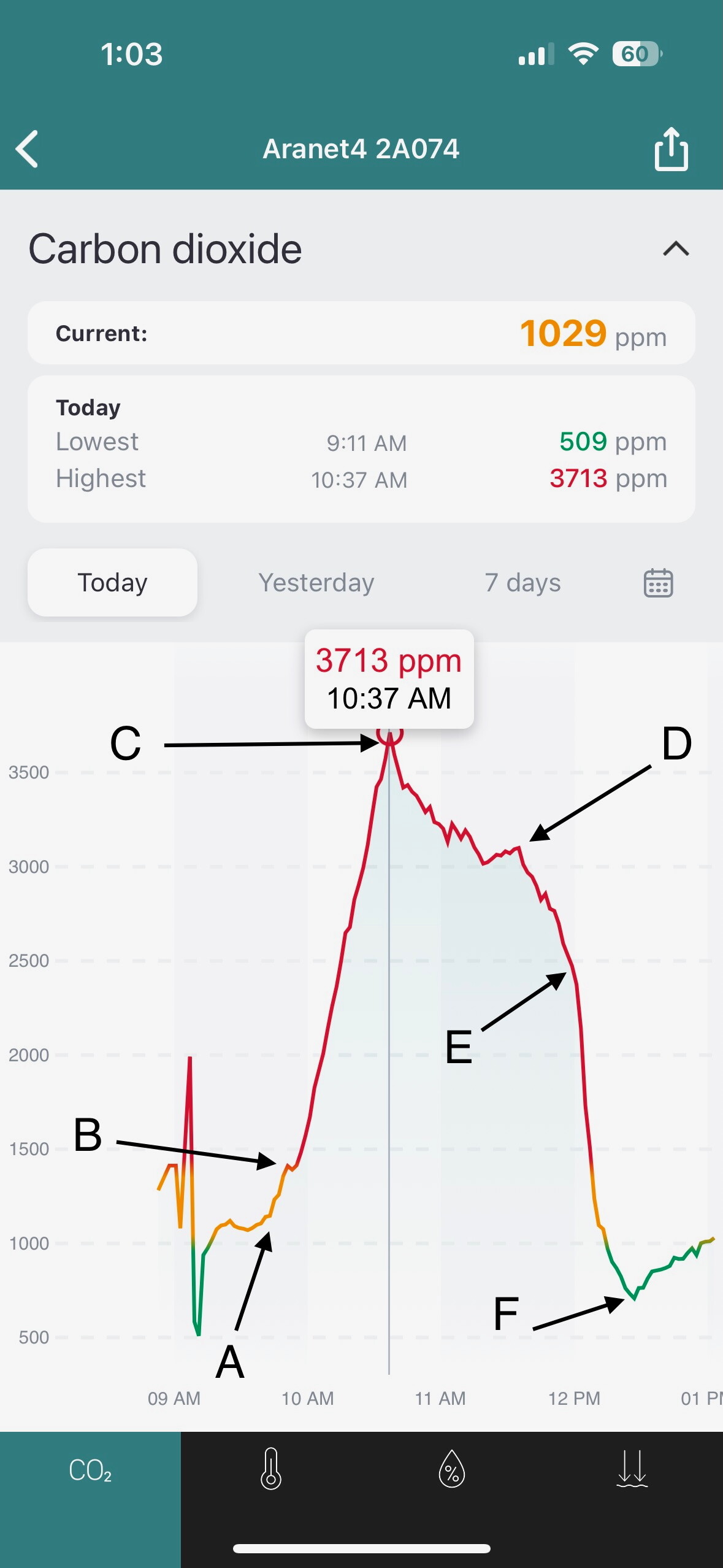

Here’s my workout today. 4x15 @90%. Workout room is our spare bedroom, which is about 150 square feet. Baseline in my apartment settled around 1,100ppm. The little dip into the green before starting was me taking the device outside to make sure it was working correctly. Started with the door closed by accident.
Reference points as follows:
A - got on bike and started warmup, no fans
B - turned on fans, small dip as the air got circulated
C - finished 2nd 15min interval, then opened the door
D - workout done
E - opened window
F - closed window
So I started the workout with the door closed. Depending on whether my wife is home sometimes I leave the door open and sometimes close it to spare her the sound of the trainer. Will never close the door again for a workout after the data I got. Made it 2 intervals in before I couldn’t take it (mentally). I’ve done long rides in there before so I have no doubts I was well over 4,000ppm on previous rides. Kind of freaky. The value dropped but hovered around 3000-3200 for the remainder of the workout. Fast drop after ending the workout, then really steep drop when I opened the window. It was cold out so I couldn’t leave the window open very long. And again settled around 1,100.
I opened the door after the 2nd interval, but I didn’t feel any different. It was more of a mental thing seeing 3700 and continuing to go up. I’m very curious how high I would have gotten if I left the door closed but didn’t feel like subjecting myself to that (again). Needless to say I will be leaving the door open from now on. I might try to crack a window open as well but like I said above, I’m a weenie with cold and it’s really cold right now. But maybe the health aspect can toughen me up.

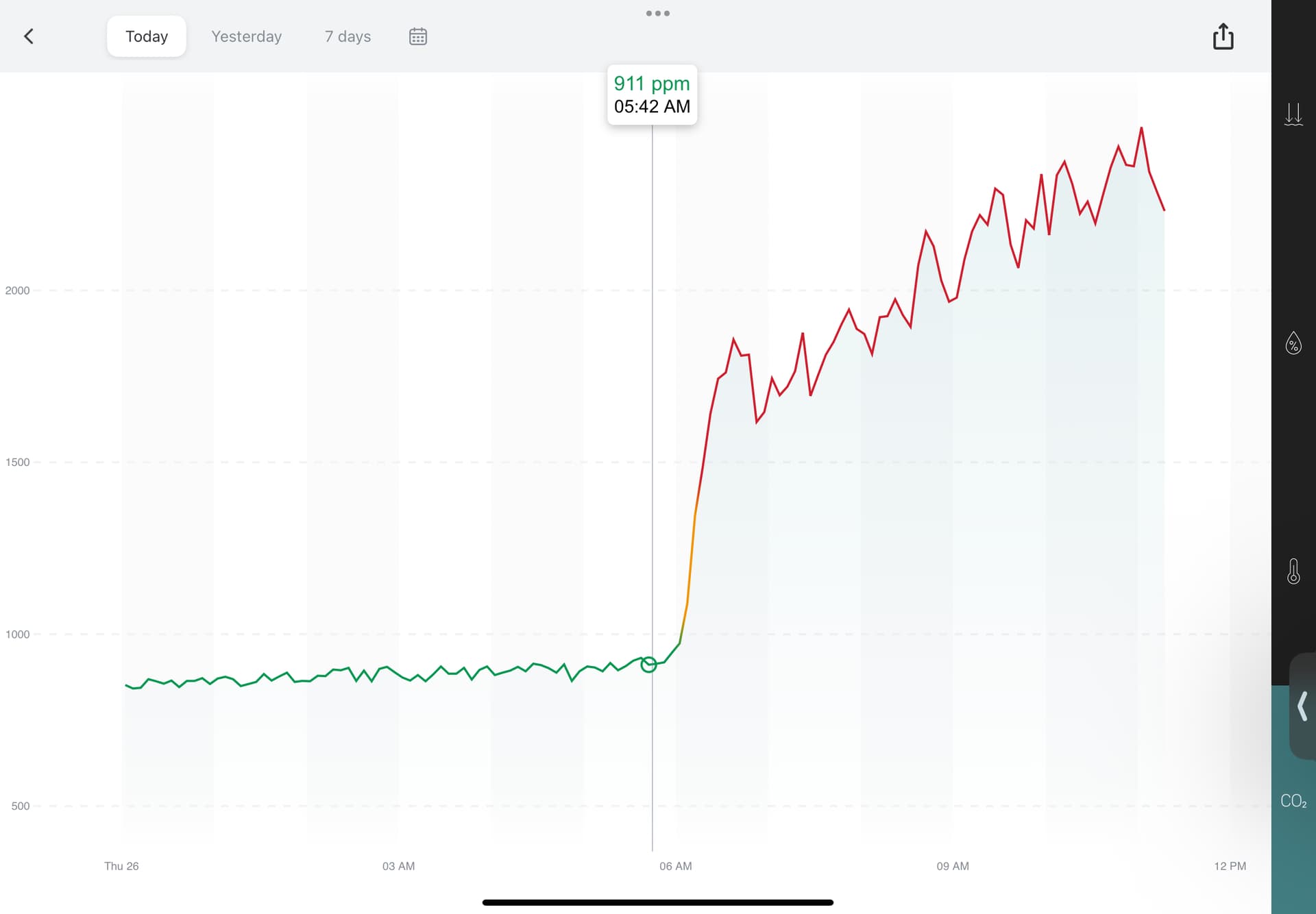

I go downstairs and look at the meter and it will read 1200 in our sealed up for the winter house. If I open the window, it will go down to 450. If I don’t open the window and do a workout, co2 will rise to 1700+ over an hour in my workout space.
This is a large open downstairs area so apparently opening a door would make little difference.
Does it make a big difference though? I’m not sure. But common sense does seem to indicate that one should open a window and maybe not train in a small, closed up room with no ventilation or hvac.
