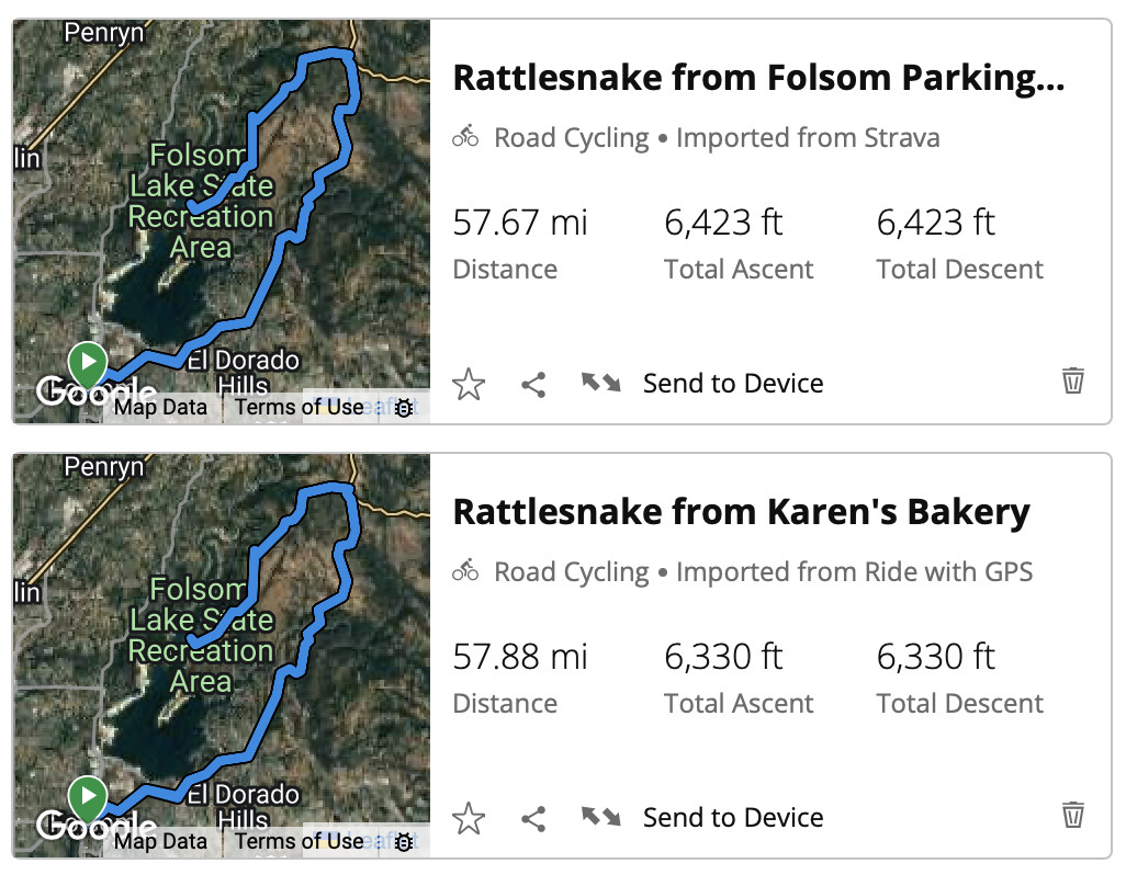

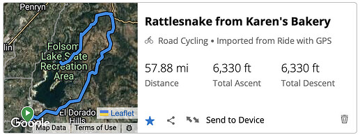

Two days ago I created a course in RideWithGPS:
57.9 miles and 6330 feet of climbing.
Pinned it in RWGPS and it synced to Garmin Connect:

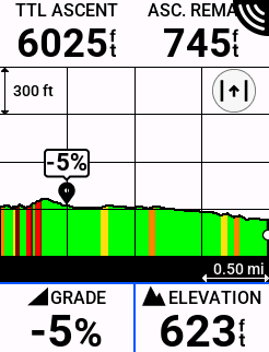

It kept decreasing the total climbing remaining during the ride, for example about 1/3 into the ride:
2023-04-30-13-37-07
the Total Ascent + Ascent Remaining had dropped to just over 7400’ total climbing.
About 2/3 into the ride:
2023-04-30-15-43-03
and total climbing had dropped to 7220.
Even later:
2023-04-30-16-36-02
down to 6770 total climbing.
Small route change, probably a small 100’ bonus climbing, finished at 6529’ climbing.
ok this is interesting:
  • exported RWGPS route
  • imported into Strava and renamed
  • favorite the Strava route and let it sync to Garmin Connect (almost instantly)
Here are the two routes in Garmin Connect (web or mobile):
The Strava file gets processed by ClimbPro and gives almost exact elevation as yesterday’s recorded ride:
2023-05-01-17-17-30
:man_shrugging:
More complex routes are easier to make in RWGPS, but pre-ride I prefer to review the route in Strava. Now I have a reason to do just that LOL.
