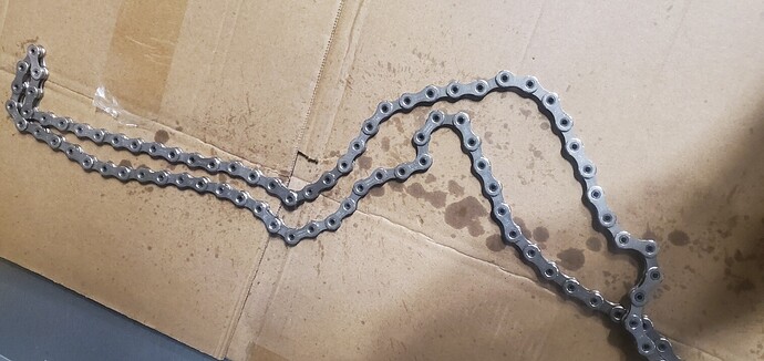

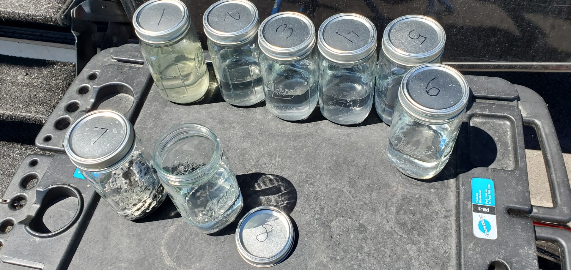

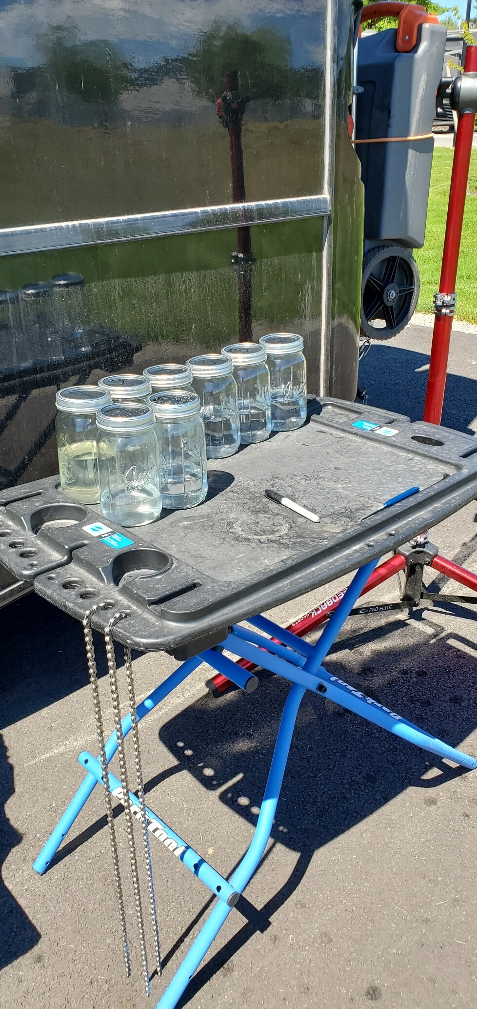

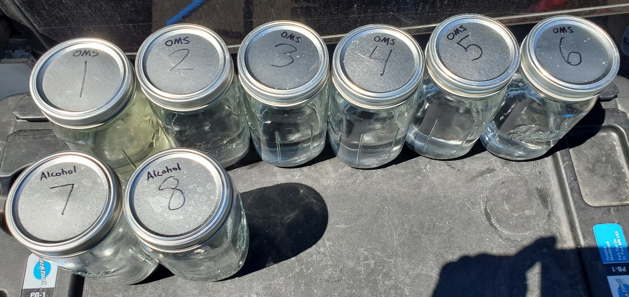

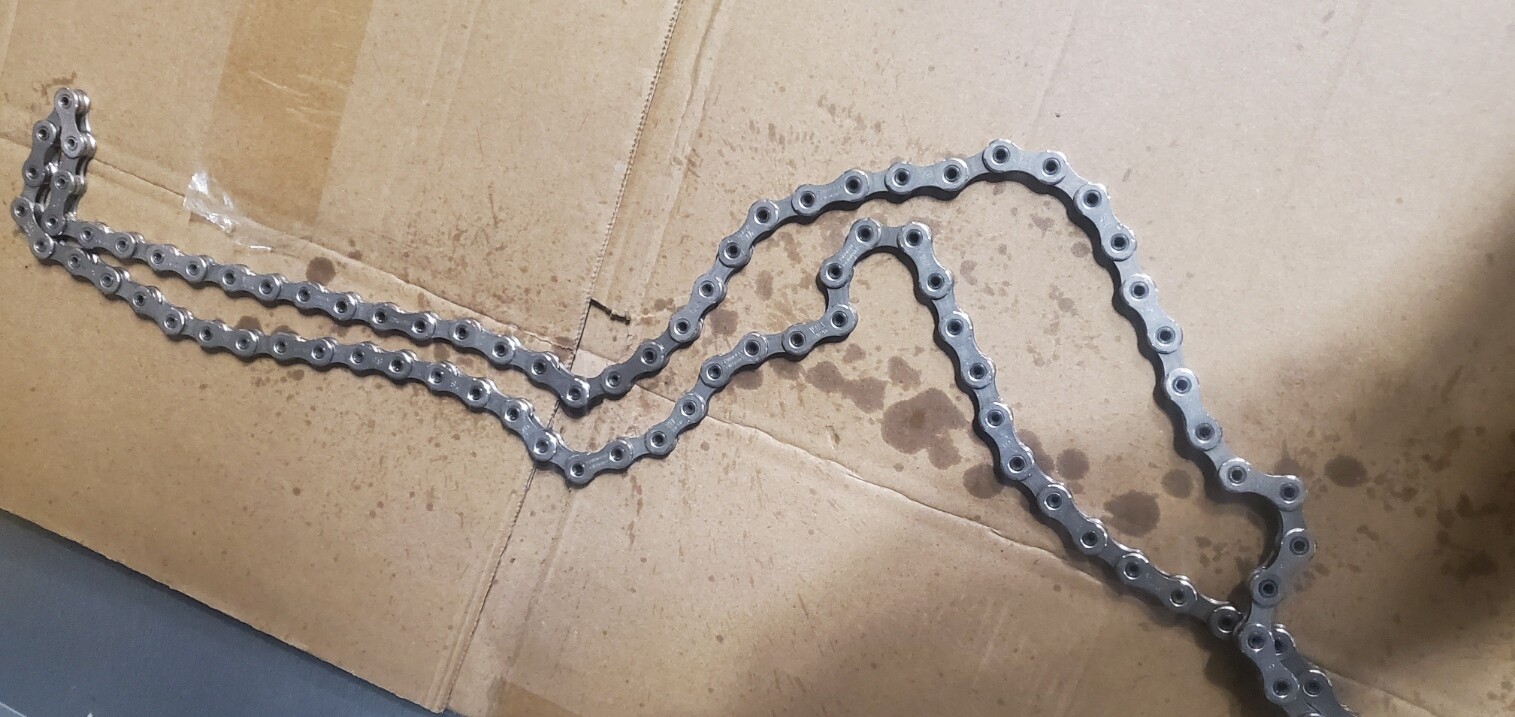

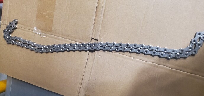

So, I took the still very slightly “gummy” Squirt-lubed Chain A (see project notes in prior posts) out for a spin last night at ~5pm in Knoxville, TN. ~80 degrees and very high humidity. Felt great riding it (on my wife’s bike, thank goodness she’s 5’9"), and it shifted great.
I wiped the exterior of the chain down thoroughly before riding. I did not use mineral spirits (see: up all night working on TT bike).
I was hoping I would come back from the ride to find the gumminess reduced/improved but it was dramatically worse! Strikingly tacky.
My rookie conclusions:
  1. I applied too much squirt lube. This caused gumminess even with extended drying time. Maybe bad batch too… not sure, possible but don’t think so, based on color.
  2. Riding Squirt lube in hot/humid conditions made problem #1 worse. It felt like it absorbed the moisture and turned it to glue.
  3. It’s remarkable that I could not feel that tackiness while riding, a testament to how little we can actually feel when we’re losing watts or when something is 1-5 watts faster or slower. There’s lots of placebo going around these parts!
  4. I love how clean the chain is.
  5. The chain was loud and I hated the loudness of it, especially when mildly cross-chaining.
  6. NFS on an aggressively-wiped-down, lightly used but never-degreased chain is at least reasonably fast. I may just clean a new chain and break it in for an hour or two with NFS in the future. If waxing only saves a single watt over NFS, then I’ll probably continue to use NFS, Synergetic, or Rock & Roll in the future.
Is the general consensus that waxing is roughly 1 watt faster than the best drip lube, assuming a broken-in new degreased chain with each treatment applied appropriately?
I do wonder if some of those organic solvents you used to clean the chain leave a residue that affects the wax. Honestly I ride my squirted cross bike through wet and mud all the time, and it doesn’t get tacky. I’d wash that chain in hot water (with soap), and see if it gets clean. Then just let it dry a bit and apply squirt afterwards. Leave all the mineral spirits etc off. (If hot water doesn’t work to clean it, you know you got something other than wax in there for sure. But I’d think its dissolved in the wax now and will come off with it.)
Noted!
In the future, how would you go about applying Squirt to a new chain? Are there different solvents you use to degrease?
Can’t help, never degreased a new chain…I just ride it in wet muddy races until the factory grease is gone… then maybe use bike degreaser and then water and squirt. :joy:
This very rough cleaning process is likely the reason I can’t get it to last very long, but it does work for me.
:joy:
And to think I bought jars and mineral spirits and still got a crummy result. All I needed was some water and grit.
