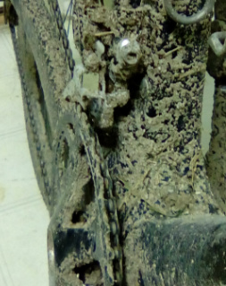

WHEN IS IT A GOOD IDEA TO WAX? When your bike ride makes your bike look like this:
image image
This is my bike after I won a gravel endurance ride. The weather looked sloppy so I broke out my mini crockpot, ptfe powder, and gulf wax…waxed up a chain…swapped it on…broke it in. In this case all the effort was worth it. Squirt doesn’t perform as well in wet conditions as paraffin or products like Molten Speed Wax.
