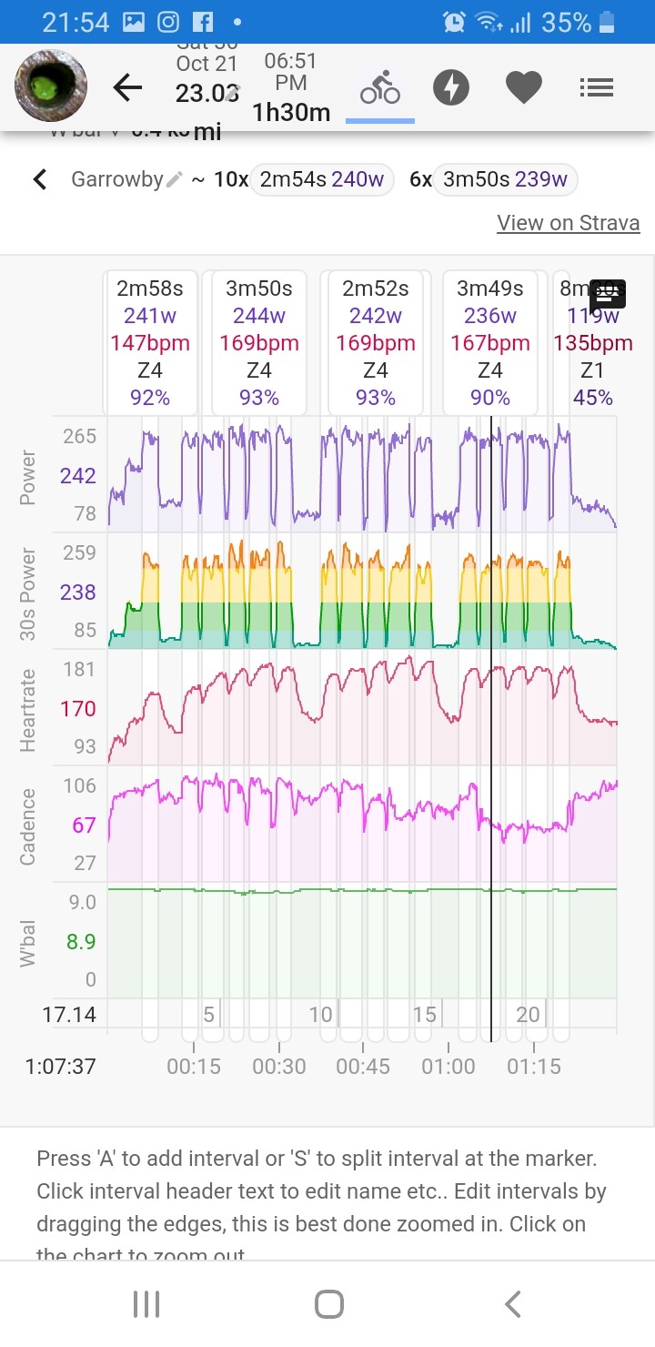

Other than the warm up, which starts to a low to mid cadence, I think I generally start of at a average to high cadence but after a few block it collapses. I can usually pull out of it with motivation but I prefer ‘resistance’ mode when I have that lack of focus. Last night work out is typical. If I am motivated though I have a high cadence throughout.
