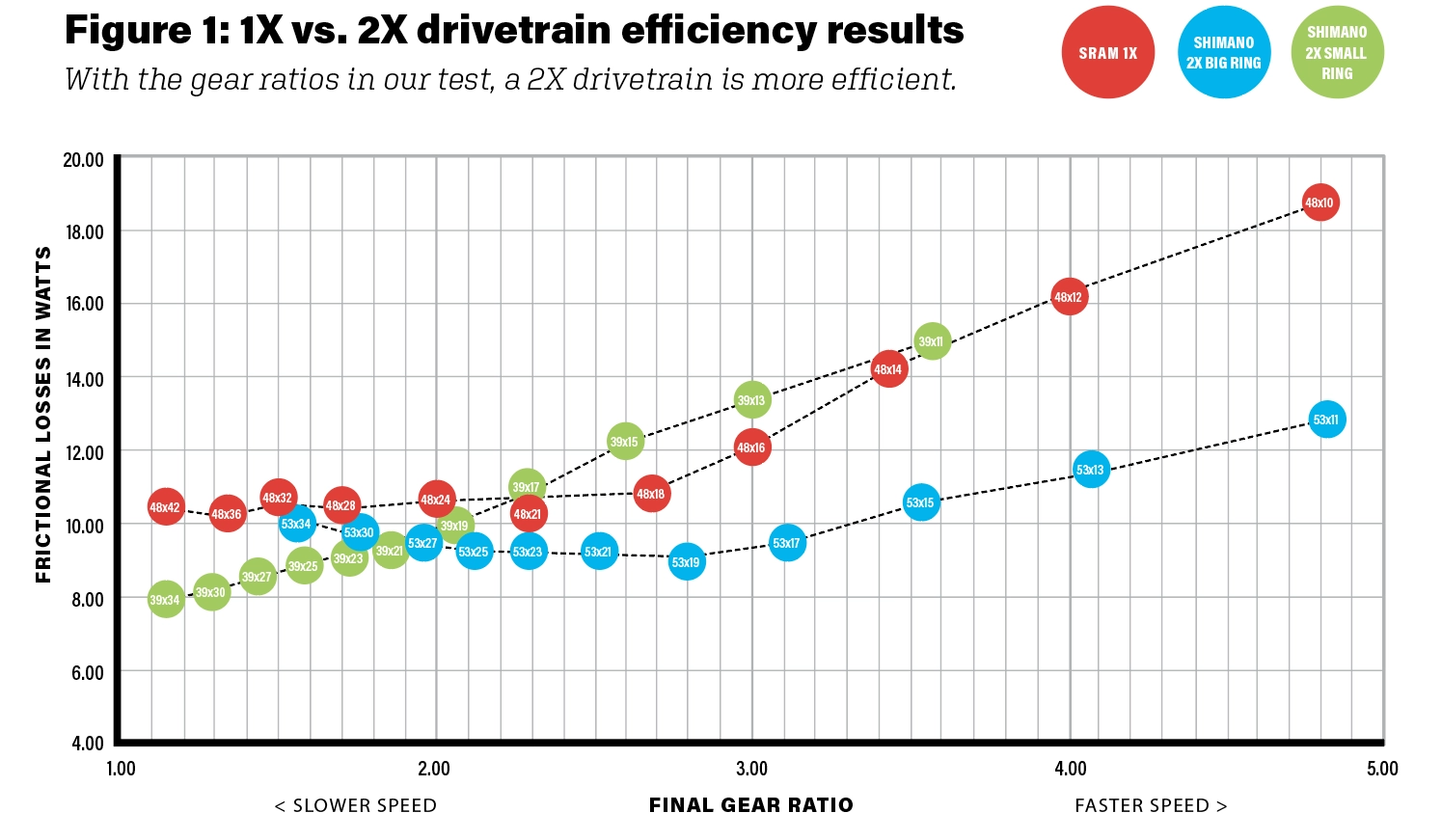

I wasn’t able to find anything on MTB specifically but the two links below compare gear ratios in a 2x setup and the second link looks at a 1x set up (more road/gravel gearing though).
I think the biggest gains aren’t from less chain wrap at the front but rather by a better chainline or bigger gear in the rear. Based on that second link there is much more friction in the small side of the cassette than the large side in a 1x setup. 48x21 costs you about 10 watts while a 48x10 costs you 18. So going bigger in the front will probably save you 0.5-1W from the front and then maybe 2W from using a larger cog in the rear.

Based on this chart and making some hopefully reasonable assumptions, you are probably looking at around 1-2w depending on the chainline between a 32t and a 36t
A 2.0 ratio corresponds to a 36t/18, 34t/17 or 32t/16 which is going to be close to the middle of the chainline for mtb.
Which isn’t bad tbh. An extra watt or two average over the course of an XC race is probably ~5 seconds.
So when talking about chain wrap or chainline friction losses. How does that scale to either RPMs or chain tension?
E.g. say that 2 watt gap between the 11 and 10 tooth cogs in that graph at 100 RPM and 250 watts. Does it scale linearly with both? So at 110 RPM is it 2.2? Or in an all out sprint to the line at 1500 watts and 115 RPM is it now 10+ watts?
